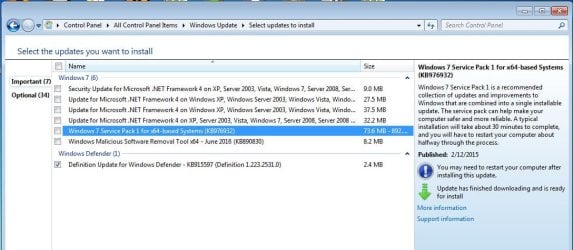

I have installed all of the available Win 7 updates, except the ones shown in the screenshot #1
Screenshot # 1 attached
The SP1 update is item 5. I select only item 5 and click “install”. Install proceeds -- to a point. Sometimes during the install I receive a “failed to install” with error code 80070002, twice install has completed and Windows has asked for a restart to finish the install. When restart is complete, with no error messages, I check status of updates. Status shows SP1 install as “failed” .

Also, trying to individually install each of the first 5 updates in the
screenshot #1 produces the 8070002 error code before the update install finishes.

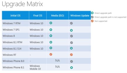

Actually, you don't need to do that to upgrade to 10, that is only if you want to upgrade through windows update,
Windows 10 - Upgrade Installation - Windows 10 Forums
All but one or two of the methods there will upgrade for you.
If you are having problems like you mention with 7, you may want to just clean install 10 using your win 7 product key on the COA.
Windows 10 - Clean Install - Windows 10 Forums
