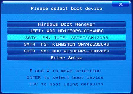

You may try seatools for windows. But It is not very effective with problematic Discs, whereas I am thinking your HDD is problematic.
To boot from the USB, either you need to enter into the BIOS or you need to use the boot menu key to select the USB at boot device. In normal course it would not boot from the USB directly.

I did try it from the motherboard's boot menu. It was after I selected the "u disk" entry that it booted to the desktop. How would I do it from the BIOS?

Connect the USB to the computer and restart.
Tap the F12 key on the keyboard during booting, and press it frequently. It will give you the boot menu key ... like this one.
Select the USB stick using the up/down arrow key and hit enter. It will boot from the USB stick.

Actually, that's the way that I tried. I'm sorry for getting it wrong. Is it worth changing the boot order in Windows?

You can change the boot order for the time being. But the boot menu key works all the times, and it is the easier option.
