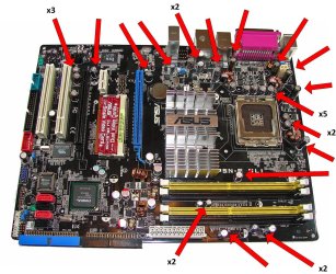

Twice this condition was caused by defective capacitors on the motherboards. If this is the cause, it is a degenerative condition that will continue to get worse until there is complete failure. The condition can place other components at risk for damage as well as your data.
Are you comfortable opening up the case and looking at the mobo? There are around 30 "black" colored capacitors with silver tops that you need to look at. The tops should be flat to slightly depressed. If any are bulging outward, they are defective.
Look at the caps pointed out in this drawing. Pay particular attention to the dozen or so caps around the CPU socket. If any are bad, either a) replace the caps (not the easiest job to do) or b) replace the motherboard (much easier to do).

Be sure to check the capacitators first as GEWB seems to spot it as the issue.
I checked every capacitor on the keyboard. They're all still perfectly cylindrical.
