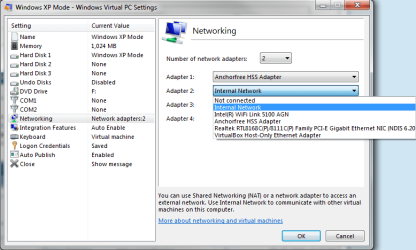

First of all, I think you might need to set up an AD HOC network between the host and XP Mode. For AD HOC, you need to use two NIC's on XP Mode (settings > networking): this USB adapter of yours, and your host's NIC, shared NAT or Internal Network.
Then you have to bridge the XP Mode network connections and allow ICS (Internet Connection Sharing).

It might be possible using two NIC's on XP Mode, setting it to use a shared NAT or host's NIC as Adapter 2 in settings, then creating AD HOC between the host and XP Mode (using this second adapter) and bridging connections on XP Mode.

I still think your best bet would be to create ad hoc connection between your host and XP Mode, and then bridge that connection with XP Mode's net connection. I have no time to test it now but I will do that tomorrow and report my findings here.
