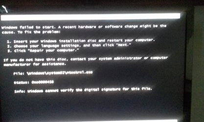

I started over.
If I understood well, it's possible to boot a USB NTFS flash drive with the files extracted from boot.wim.
There was no Boot folder
I opened the Easybcd:
- Under BCD Deployment I installed BCD. A boot folder was created
- Added a new entry (windows tab)
I tried to boot the USB flash. This time it didn't gave me a BSOD.
It gave me an error: ntoskrnl.exe not digitally signed.
How to turn digital signature off?

2. Boot win7 ( the full win 7 OS ) over usb. That is doable with the registry changes mentioned previously - winntsetup provides a method for it.

I copied the created Boot folder on post#4 to \Windows. It gave the same error: ntoskrnl.exe not digitally signed. Can you detail "If you are trying that with 17514x64-v6, the full Windows\Boot folder is not there. You would need to copy the full Boot folder from the root of the media into the extracted Windows folder. Then you should be able to run bcdboot command outlined by MS."
