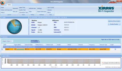

3. Xirrus data
PS: With this Xirrus download I got all kinds of junk. Took me a while to get rid of it. So be careful when you deal with it.

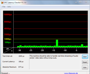

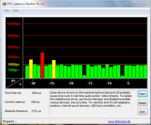

I may have found something but am not yet sure how to deal with it. When running Process Explorer during bootup, I noticed a slightly higher than usual interrupt activity. So I decided to run the DPC Latency Checker.
Below are the results of when the system is stable (first picture) and during bootup (second picture). The bootup situation clearly points to some driver problem. I have, however, checked all the Network device drivers and the system makes me believe that those are OK. If anything, I would suspect the Netgear router and I will look at their website whether there is a new driver.
