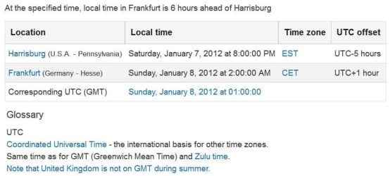

I expect to be finished, and posted 'bout 8pm EST (20:00GMT) my time. Approximately 6hours behind you, 2am Frankfort - Hesse time. (02:00GMT 01-08-2012)
Source: The World Clock - Time Zone Converter - U.S.A. – Pennsylvania – Harrisburg vs Germany – Hesse – Frankfurt
My current time as I post: 5:52pm EST (22:45GMT)
