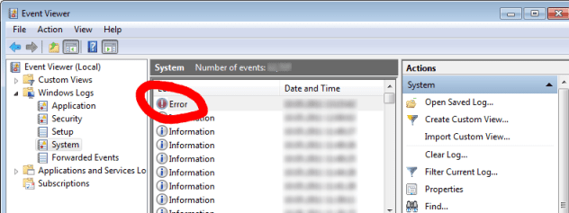

You can try to spot errors with Event Viewer.
Open the Start Menu, and type eventvwr.msc in the search box and press enter.
If prompted by UAC, then click on Yes (Windows 7) or Continue (Vista).
In the left pane of Event Viewer, double click on Windows Logs to expand it, then right click on System and check for errors (see screenshot). If no errors related to IE will be in System, please check Application section.
Please post description of errors occurred within the described time of those programs starting.

Hi Neutron16,
Thanks for your post, it solved my problem!! (wait till you hear what the problem was... its soooo sttupid.. :) )
First, sorry for the late reply. Ive been waiting for my post to appear in the General Discussions thread where I posted it (I think). Says it will be reviewed first so ive been waiting but havent seen it appear after several days have passed. Finally did a search and found out it was transferred in the Software section. :)
Was still having problems with SOME software, like I tried Safari browser, same slow launching like itunes. (Chrome and Firefox runs ok)
I did what you suggested and immediately the problem presented itself: There's an Error happening EVERY 1 to 2 SECONDS!! Source: CDROM.
The cluprit: A FAILED BURNED DVD inside my DVD drive.
A few weeks back I was going through some of my burned and blank DVDs and sorting them out. Many are unlabelled so i was checking them out by putting them inside my drive to see whats in it. I inadvertently left a "coaster" disc in my drive and forgot all about it. Thats whats been causing the problems!! duuuuhh... I feel so stupid.. :(
1) My PC is under my desk so i dont notice if the drive is blinking or not. So my PC has been accessing that disc EVERY 2 SECONDS for the past few weeks?? I leave my PC on 24/7 most of the time so i shudder to think of the waster power. Not to mention wear and tear of the physical drive (not sure if it was spinning?) Hopefully it can still write dvds..
2) The moment I took out the dang disc, I tried launching those problematic programs and they ran instantly. No more issues.
3) Im just curious why under Windows XP (on the same machine, which is dual boot as i mentioned earlier) There was no issues like this even when the same disc is in the drive? Is this a Windows 7 thing that tries to access the drive every 2 seconds?
4) I think its not a coincidence that the programs ive had problems with are media players of some sort (XBMC, iTunes) although Safari is a browser. I take it they are trying to check my drive for some playable media? But even so, why the looong delay? Why not return an error outright?
5) I still cant get over the Event Viewer is showing error EVERY 1 or 2 SECONDS for the past weeks!!!
Anyway, thanks so much Neutron for the help. I was seriously thinking of reformatting and reinstalling Windows7 just to fix this issue. Turns out it was a SIMPLE MATTER OF TAKING A STUPID DISC OUT OF THE DRIVE. (Sorry, still cant get over that!) :)
