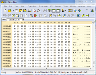

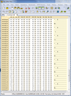

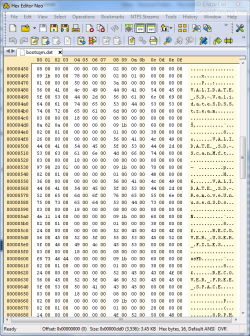

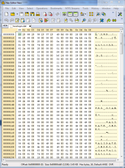

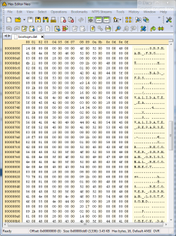

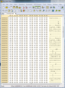

This file is automatically created when chkdsk is either automatically or manually invoked on your hard drive. It is basically a scratchpad for use by this command so that it can keep track of what, if any, corrections it needs to apply to the disk. It is not automatically deleted, however you can manually delete it should you wish. It can be found in the root folder of your HDD and is a 4KB file.
The following images show the resultant file on my system after running chkdsk on my W7 Pro 64-bit partition with a clean result:
