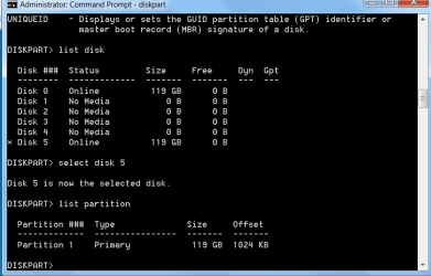

Ok Shawn have found the "missing" drive and am now diskparting it as per Wolfgangs tut and am up to what is in the pic however I still do not see it in Computer?

The new firmware may help, but I would think that you should still be able to see the SSD when connected without it though. I'd wait until after being able to see the drive before trying to flash it.
If Disk 5 is the SSD, then while in diskpart, you might run the Clean (not "clean all") command on it. When it's finished, then create partition primary (option two) on Disk 5. Hopefully you will see the SSD afterwards.

Hiyya Shawn all fixed I did what you suggested re another machine and that is where it showed up - the rest is history. Why it wouldn't show up on my main machine is very strange but there again I have a few problems there with the SSD and the older HDD playing silly devils:confused:
