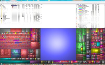

Waiting to see the WinDirStat screenshot to give us the picture.
Your SSD should be plenty large for OS, programs, System Managed paging file and Hiberfil if you want to use the modern suspend function.
windirstat
Hallo Gregrocker,
Thanks for wantin to help.
First of all, is this the windirstat screenshot you wanted, or do you need the whole picture?

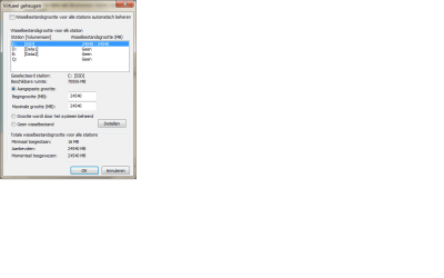

I am also sending you my RAM situation and how my pagefile is organised, if that helps.
My system restore was switched off from the begininning powercfg -h off.

Looks like you've set your Paging File to 24.5 gb which is way too high since the System only sets an amount approx equal to your physical RAM. This is why I don't recommend messing with it since this function is perfected in Win7.
If I were you I would tick the Box for System Managed Size, highlight C drive, then check the Box to Automatically Manage, click OK and Apply.
Once you see what size is then allocated at the bottom of the Virtual Memory box, let us know if you think it's more than you can afford on such a large SSD.

I changed the virtual memory setting as you advised and immediately gained ....13 Gb on my ssd disk.
I'll send you the new screenshot and perhaps you could look if this is how I can leave it.
I'll also send you a complete screenshot of my windirstat.
Are there any programs on my list that you would advise me to transfer to my D disk?

You want System Restore as your first line of defense in case of catastrophic problems. Let the System set its size as well and don't reduce it unless absolutely necessary. System Protection - Change Disk Space Usage
I like the Hibernate function so I can walk away from my PC and not have to worry about saving my work, so I don't encourage others to sacrifice it since there's no need.
Make sure all of your data is in User folders you set up on your HDD and then link to the related Library - Include a Folder - Windows 7 Forums.
If you get low disk warning on the SSD, uninstall lesser used programs and then reinstall them to the HDD.
Looking at the specs.doc in post #4, I think pmk does have 16 GB RAM.
I doubt a 16 GB pagefile is really needed, so I would manage the size myself with a 1 GB minimum and 8 GB maximum.
This should allow creating DMP files if ever needed, and allow programs that do want to use it to not cause errors.
For Hibernate the default size is 75% of RAM.
It can be adjusted down to 50% of RAM.
The Page File (pagefile.sys) can be moved to a different drive/partition than the C: partition.

David, does the page file also benefit from the faster speed on SSD under most circumstances? Is it even used much with 16gb RAM so that it matters where it is?
Greg, with 16GB of RAM, the pagefile will never be used. Those hard faults you see in e.g. Resource Monitor, are fake faults. Someone is only using the paging algorithm to get his bits into RAM. That's why I always reduce the pagefile to 2GB - some even 1GB.
Hi Greg,
After the last message I just read concerning turnining my pagefile down to 2, or even 1 Gb. I don't quite know what to do.
In case I would have to change, how would it have to look?
I am enclosing the situation as it is now, once again.
My question probably sounds stupid, but I have no knowledge or experience on this matter whatsoever.
Thanks, Peter
Did the screenshot of windirstat make any sense?
Greetings, Peter
