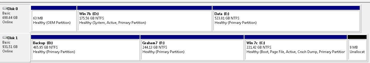

This thread has been helpful but before I try changing the system I would like confirmation of the steps to take.
Drive 0: three partitions . OEM partition, Win7b (D) system, active, primary partition, and Data (E)primary partition
Drive 1: three partitions . Backup (B) primary partition, Data2 (F) primary partition, and Win7c (C) boot, page file, active, crash dump, primary partition
I want to move the system from the partition on Drive 0 to the Win7c partition on Drive 1 and retain the abillity to boot to either Win7c or Win7b partitions. At some stage in the future I will replace the current drive 0 with a solid state drive and reinstall windows 7
Solved: Answer given elsewhere
