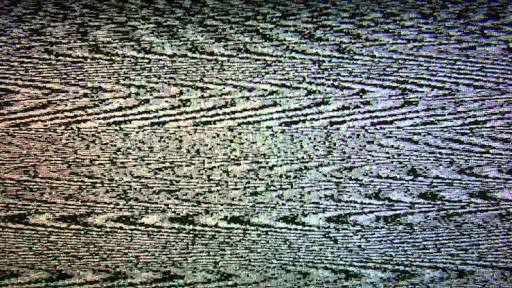

My friend has explained that he was simply watching a TV show, left the system paused for 10-15 minutes and upon return it was in Windows Startup Repair. The owner of the PC is not very technical and doesnt remember doing anything special prior to the issue.
He did say at one stage the system booted through to Windows, however the screen was illegible resembling and old VHS, similar to >> https://encrypted-tbn3.gstatic.com/images?q=tbn:ANd9GcSrMstbXORuJ_354-BUZbr603d9Oed5vQsi54Ijmxuk-QZB_8gtwGy9EQAV
Any other possible suggestions? At this stage I'm about ready to give up and clean install.
