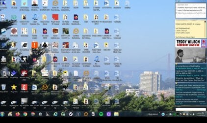

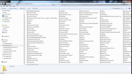

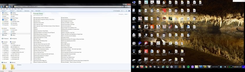

A bizarre thing is happening to my icons, in particular my folder and my pdf and my Word and jpeg icons on both my Windows 7 C: and E: drives! I am attaching two screenshots of the square, a weird overlay on some and just subtitution on others. When I refresh the screen, everything appears as normal, then everything changes to these weird icons!
I would greatly appreciate some help as to what is going on. It doesn't seem to affect the programs or files directly.

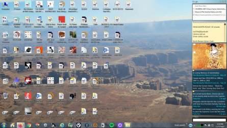

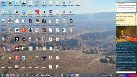

I have deleted the icon cache several times, booted, rebooted, and with the last reboot the desktop was clean for about ten minutes and then reverted to the corrupted icons and thumnails. But the mystery deepens! I noticed that the files in my documents folder had normal icons and thumbnails, so I refreshed the desktop screen and all the files reverted to normal look. then, again, I am noticing a slow corrupting look as slow many of the icons get corruped. What is going on?
I am posting a screenshot of my clean desktop upon reboot and one with partial corruption and one fully corrupted.
