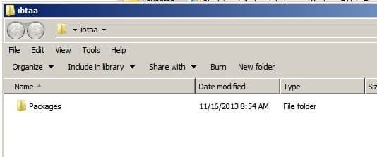

I downloaded the zip file, but when I extracted there was only 1 folder??? I even deleted the folder and did another extract, still only 1 folder.

Sorry - my fault - I forgot to mod the instructions :blush: !
One folder is correct here - there's only the Package files to replace.

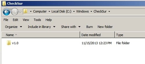

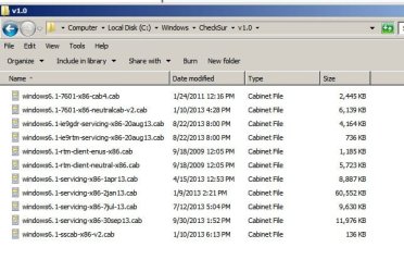

Is this the folder you want? This sucker is 108 MB

It tells you in the Windows update posting Instructions sticky in this forum (posting from my phone)

The good news is that I can see no obvious major errors in the components file - so this should ultimately be fixable.
Now we need to do some registry manipulation.
Have you ever used Regedit? - how comfortable are you with it?
If you're reasonably OK with it then follow these instructions (If you're a total beginner, shout, and I'll go into more detail). As always BE CAREFUL - mistakes in the registry cannot be easily undone, and there are almost no built-in safeties.
Open Regedit, and navigate to the
HKEY_LOCAL_MACHINE\SOFTWARE\Microsoft\Windows\CurrentVersion
subkey - find the
Component Based Servicing
subkey, and right-click on it - select Export
give the export a name, and change the 'save as type' to Registry Hive Files
Save it to somewhere safe, then exit Regedit
Now compress the saved file, and upload it to your reply.
