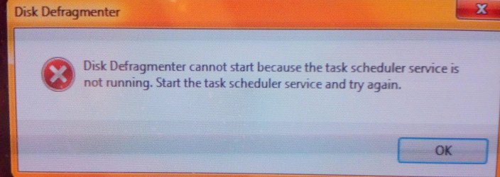

today with out me changing any settings that I remember, except add a firefox update,
my computer after a restart failed to bring Advast on, I restarted and got the flag window you see attached as a photo below about "Net Framework"
many of my tray icons would not appear, I went to do a restore, only to find the only restore point i had was today, I may have cleaned them out during a recent disk clean.
but I was able to tract one (old recovery point) down in my jet clean recovery which I ran and it cleaned up somethings tho some desk top short cut had to be put back in. Advast had to be turned back on
all this stuff started when I tried to enlarge a picture on the net, which some how instead enlarged my short cuts desktop home screen. and it would not shrink back hitting CRT - (minus)
right And after I did the new firefox install-
which i always fear for my life using a new FF download ever, cause it always screws something up, I dismissed it for weeks but today broke down and downloaded.
now comp comes on but I get the attached pic, it says I need a install net framework v4.0.3019
where do i get that , or can I delete the latest FF download out to no longer need v4.0.3019 ???
Boy "Sand Boxie" here I come after this.
And THANKS to all who help ;) and if you need sleep go to BED.
PS I am running Kerperski scan now-update "Scan done" no issues
Update - cant run disk defragger
update-
now disk defragger worked once, and now won't run again
and advast icon has disappered from bottom tray again, so I can't tell if its running????
As you dear reader might see as well, I am having a hard times with keepers my settings
stable/reliable

Hi Jim,
Bear with me, this could be a bit long winded
Create an EXTERNAL backup NOW
What printer do you have Brother ??
If so is it integrated into your system, i dont just mean drivers for the printer
Open your picture library, if its intigrated you will see Brother 2nd line under the action options, File/view etc
So whats he talkin about your thinking
The second screenshot you posted relates to a program installed by Brother. TwDsUi
(the Ui bit infers integration - and it will affect your desktop, background operation)
Has this been recently updated??
is so roll back - turn off auto update first, within brother
if that fails i would unistall it.
Now as for Avast!!!, not Advast, and disk defrag
Disk - have you changed the scheduler within its options
note not required if you have an SSD
Avast - has an auto updater Task, which is run as soon as you logon, not sure if it doesn't update that the icon dissappears because of your icons notifications settings.
notes
its a resource hog, i personnaly would opt for Bitdefender free
NEVER run more than 1 AV
finally, Task Scheduler
Its a very important system feature, and should never be turned Off affects myriads of programs
turn it on and reboot, is it still on if not we will need to find out what prog is turning it off

finally, got into task scheduler, all tasks are set for on, but other wise it will not respond to my commands got a screen shot of the "On Switch" ????

hi jim,
task scheduler settings in Services, should look like this, see screenshot

jim,
screenshot of computer from Orb - integrated, read Brother for Epson.
note i am also linked to the same printer but i have only installed the drivers, so no UI on mine

All so MS says I already have a .net frameworkv4.0.30319 but i still get pop up saying I need it.
I really know how hard you guys work, so I try to bring humor and gratitude to my threads
but i am not laughing now, printer works. pop ups says it wont, MS says I already have the net frame work.
Roy, how can I dump brother bohemiath huge program that has telemetry, install brother simple driver.
and end getting the warning pop up I left in another post.
jim

BIG MESS
ok i deleted what parts of brother i could dig out with a pick, cause it don't wanna move
down loaded simple driver from brother that works like a junk yard smells.
but I still can not open other programs cause i still need net frame work net frameworkv4.0.30319
UPDATE
please use exact names, there is no "picture library" but in "My Pictures" correct name-i found some brother junk and deleted it.
in task scheduler I found no screen as the one you posted, i did find a refresh, I refreshed, it says 5 program's have failed.
and some programs still do not open and still want a net frameworkv4.0.30319
UP DATE
this net frameworkv4.0.30319 will not install because i already have it,
i presume then something in task scheduler is still goofy ?????
Y17C_C1_ULWT_PP-usa-inst-F1 IS THE BRO DRIVER for printer, when i try to run it, it opens a big file of stuff.
but no program runs.
enough wasted time for tonight, be back tomorrow to see what you say
sleep tight every one
UPDATE I seem to have got the tiny brother program to print
so I assume the task issue is next, the picture was kind but it never got me there as you present in picture
and please remember i have not a clue in the world what 99# of all these initials your using mean.
so stating with names-where do we go to correct tasks
thank you
