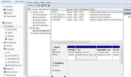

After the startup I see that the error is occurring because of some very fast flashing of probably autorun pop-ups. Then I get steady autorun pop-ups, I can close them but they keep reappearing very fast. Then I check the Start-> Computer and there I see a nervous flashing of the G drive appearing and disappearing.
I ran the Disk Management, see picture, but it does not appear there, you can see the G drive at the left. When I right-click on it, you get what you see in the second picture.
I must say that for the first time, after running Disk Management, the G drive 'relaxed', no more autoruns, so at the moment it is not causing any problems.
I also did the file checker scan several times, booted twice, but it did not find any integrity violations.

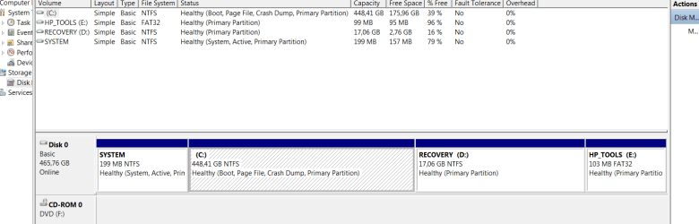

That's a good sign that SFC did not find any integrity violations. Your system files should be OK. I'd like to ask you to do something. Please post another screenshot of your Disk Management. But this time, expand it so all of the partitions on Disk 0 are visible. (You accidentally cut it off at the "HP_TO" partition.) We need to see if the G: drive is another partition.
In the screenshot above, put your cursor on the vertical line where the red arrow is. The cursor should change to a double arrow and you can drag the screen to the right to show the rest of the partitions on Disk 0.

I have noticed that your G drive has a funny flag on it (in the left pane of your second picture). Unfortunately the posted picture is too blurry to make it out. Maybe you can have a closer look what that is.

WHS: it is a small blue question mark.
Marsmimar: I made a new screenshot, although it is not the whole screen,
there is nothing more to see than this. I cannot expand the text on the E drive
further, but I assume it only says 'Primary Portion'

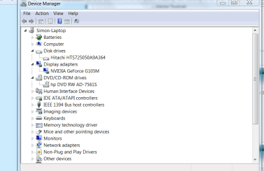

Hmm, next time it appears, check in Device Manager > Disk Drives whether it appears. But first enable "Show hidden devices" under the View tab.
Wolfgang, do you think this mystery G: drive might be a card reader?

Hello Whs,
herewith the Disk Drives of the Device Manager, Show hidden devices is enabled.
