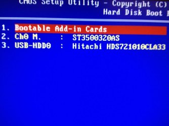

Hard Disk Boot Priority is (When both of the Hard Disks are unplugged):
1. Bootable Add-in Cards
2. Ch0 M. : ST3500320AS
Hard Disk Boot Priority is (When the first one in plugged)
3. USB-HDD0 : Hitachi HDS721010CLA33
Hard Disk Boot Priority is (When the second one in plugged)
NOTHING, I CAN'T GO TO BIOS SETUP (The keyboard won't work, I have two keyboards that one of them use USB and another one uses PS/2 to connect to the computer and both of them will not work.)
Hard Disk Boot Priority is (When both of the Hard Disks are plugged)

I'm thinking that bootable add in cards as your first boot is the problem. Two ways most boots are set up.
1. Drive where operating system is located first boot, (in most cases C on disc 0, zero).
2. DVD/CD drive first boot and drive with operating system as 2nd boot.
Your computer is trying to boot from your external drives.
I have never used a Gigabyte motherboard so I really don't know it's bios setup procedure or terminology.

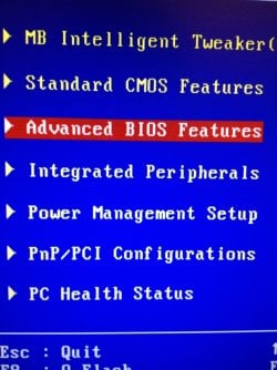

I have uploaded some images so could you explain more specifically
Thank you.

Usually you can change the order by pressing + or - on your keyboard, or it will say a different value on the right to change order.
You need to move 2. Ch0 M. : ST3500320AS to the 1. position.
Then press ESC to exit, and when in Main screen ' SAVE and EXIT' or hit F10

I moved it but still nothing happens, it keeps rebooting.When I put the first boot device to "CDROM" the computer boots up but when the second drive is connected it won't even in "CDROM" boot.

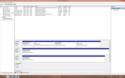

Did these drives boot ok with Windows 7, or what did you have installed before Windows 8 RTM?
Also are you able to connect the drives once you are booted.
Can you then go to Control Panel>Administrative Tools>Computer Management>Disk Management
Then take a screen shot, or look to see which drives show as Boot, or Active.

The first one after two restarts, yes it boots OK.
The the second one is new and I haven't tried it on Windows 7.
Yes I am able to connect to them after the computer boots up.
Thank you.

Have you always had your Main drive C: partioned into 3 different partitions?
I am maybe just guessing here if that is the issue or not. You have lots of external space so just curious why you would want to partition your Main Drive.

Thank you all guys
I have disabled the Legacy USB (it was enable) and now both of them are working properly with no problem and computer boots up properly too.
Thank you,
