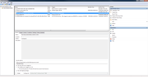

7. Under the General tab, type in a name for the task (ex: Program Name "Core Temp"). (see screenshot below)
8. Under the General tab,
- If Used in a Administrator User Account
- Check the Run with highest Privileges box. (see screenshot above)
- If Used in a Standard User Account
- Leave the Run with highest Privileges box unchecked. (see screenshot above)

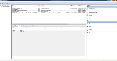

13. Click on the Actions tab and New button. (see screenshot below)
14. In the Action drop down menu list, select Start a program, then click on the Browse button. (see screenshot below)
15. Navigate to and select the program's EXE file or shortcut to the EXE file, then click on Open. (see screenshot below)

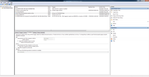

17. Click on the Conditions tab, and uncheck the Stop if the computer switches to battery power box first, then uncheck the Start the task only if the computer is on AC power box. (see screenshots below)
NOTE: This step is mostly for laptops, so that you will be able to run the program when the laptop is running on battery power.

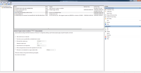

18. Click on the Settings tab, and check the If the task fails, restart every box. (see screenshot below)
19. Click on OK. (see screenshot above)
