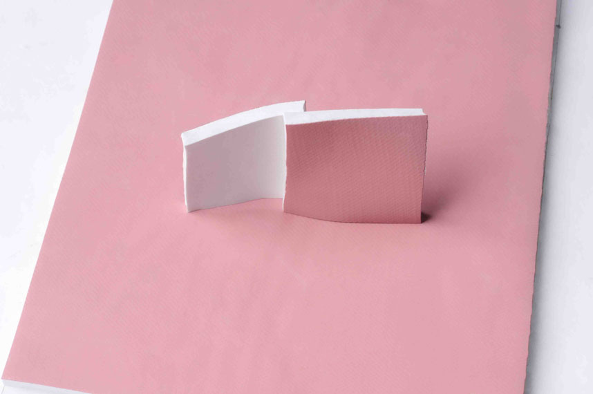

Thermal pads are a form of TIM (Thermal Interface Material) that are usually self-adhesive. The pads stick to a surface needing cooling and a heat sink then sticks to the pad. They are convenient for mass production because the heat sinks don't have to be clamped down as they would with more conventional TIM. Their downside is they do not transfer heat as well as conventional TIM. Thermal pads do not cool by themselves; they have to be used in conjunction with a heat sink.
I have read of people using small heat sinks, such as VRM or Raspberry Pi heat sinks, the size of the chips on a mSATA SSD to cool them, attaching them with thermal pads, sometimes getting as much as a 20°C reduction in heat.

Thermal pads.

I was talking about "small heat sinks" you mentioned helping loosing 20C°..
Win7x64
Win7x64
What I said (or, at least, meant) was up to 20°.
Some examples (not to scale):

Ok I have some but quite big.. The space above the msata in my laptop must be only 2-3mm.. Can I still find something?
