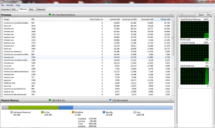

Nothing's changed. I did the Resource Monitor right when I logged on.
