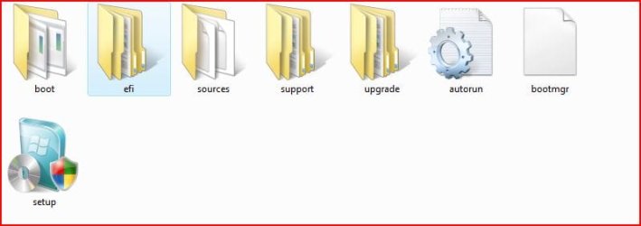

before i install is this correct
windows 7
windows 7
In the Sources folder look for ei.cfg to confirm it is deleted. If not, rightclick to Delete it.

have pm you gregrocker have found ei.cfg folder deleted it reinstalling again
