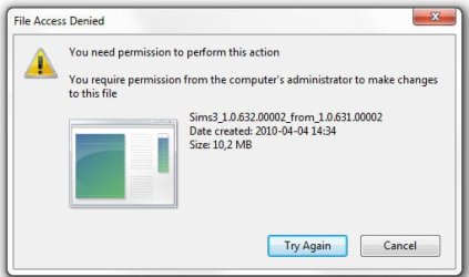

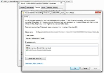

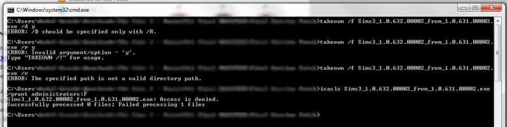

Hello,
I've seen it's a few other threads about how to delete un-deletable files but it doesn't seem to be the same problem as I have.
About a week ago I downloaded a patch for a game. I was never able to open this patch because it says I don't have permission. And now I've realized I can't delete it either. I find this a little annoying when I prefer to be in control over my files and not something else. So I thought maybe you pro's here could help me?
I have attached three screen shots of what happens when I try. First one is just normal delete in explorer, second one shows that there is no owner of the file. And the third is some tries in cmd.
Hope you guys have some suggestions.
Cheers
André

Phacer,
I ran across this problem once. The problem is that I can't remember how I solved it.
Try this:
WIN key | type cmd.exe | rt-click on cmd.exe in the program list shown | select Run as administrator
Now that you are at the command prompt navigate to where the file is located.
First try DIR to see if file is listed.
If not try ATTRIB
You will probably find that the System, Hide, and Read-only attributes must be cleared.
After clearing the attributes, can you delete the file?
If not,
Then run PowerShell as administrator.
Procedure for running PowerShell as administrator is same as that for cmd.exe
Once in powershell, navigate to the file.
now try following command: DEL nameoftheproblemfile -FORCE

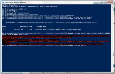

Nice, I never knew about Powershell, this is good to know! Thanks. =)
How ever the problem remains the same. Here is a screen shot of what happened in Powershell when I tried!

Hi phacer
Have you tried taking ownership of the file via your admin credentials and then deleting it?
Would be good if you log into your admin account and then taking ownership via the properties tab.
Hope this helps
Ok. Now are you logging on as administrator?
Create yourself an administrator account if you need one.
Log on with that administrator account.
I'm looking for my notes on manually taking ownership, as opposed to to using a .reg file.
Take Ownership of file - Vista Forums
Taking Ownership of Files and Folders
As an administrator you can take ownership of a file or folder as follows:
1. In Windows Explorer, rt-click on "properties" for the file or folder.
2. Security tab | Advanced
3. Owner tab| click Edit
4. In the Change Owner To list, select the new owner. To take ownership of all subfolders and files within the folder, select Replace Owner On Subcontainers And Objects option.
5. OK | OK
Assigning Ownership
As administrator or the current owner, you can assign ownership to another user or group as follows:
1. In Windows Explorer, rt-click on "Properties" for the file or folder.
3. Owner tab | Edit
4. Click Other Users Or Groups
5. Type the name of a user or a group | click Check Names | Choose the name you want if its not already filled in | OK
6. From the Change Owner list, select the new owner. For a folder, select Replace Owner On Subcontainers and Objects to assign ownership of all subfolders and files within the folder.
7. Ok | OK
What you want to do is assign yourself as the news owner.

Thanks guys!
Just now, my anti-virus program found this file after a week of having it as a suspicious file and deleted it without a problem at all. So problem solved I guess.
But I will write down what you wrote if this happens again. Thanks!
