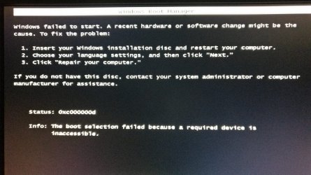

So my problem is when I try to install Windows 7 x64 in UEFI mode on my new Asus Prime X399-A motherboard (TR4 socket with Threadripper 1920X CPU installed). Also, this is being installed on an M.2 NVMe SSD from Intel 760p series.
I have made a bootable USB flash drive with Rufus and this is the error I'm getting when trying to boot from it:
Status: 0xc000000d
Info: The boot selection failed because a required device is inaccessible.

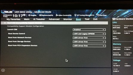

I have deactivated Secure Boot under BIOS:
Other BIOS settings I've made:
- CSM (Compatibility Support Module) configuration:
- Boot Configuration:
- Fast Boot has also been disabled

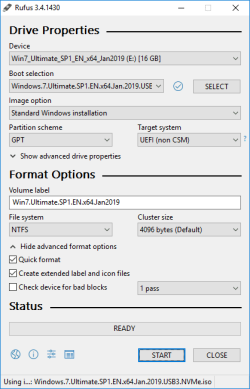

These are the settings used in Rufus to make the bootable USB:
I have to note that this is an image I made myself by downloading untouched MSDN image of Windows 7 SP1 x64 and slipstreaming Simplix update pack which contains all updates to this moment (Jan 2019).
This will make the install.wim file of 4,66GB which makes it impossible to create the bootable USB under FAT32 file system. So NTFS was the only way to go.
I'm certain that I've done everything correct when creating the Windows image with slipstreamed updates because I also tried creating the bootable USB with MBR partition scheme and installer booted just fine.

So it doesn't even care if it's NTFS or FAT32, it just throws the same error.
What I find very interesting is that the error doesn't mention any path above the "Status: 0xc000000d" line, something like "File: ...path..."
Based on what I found here, it looks more like a BIOS problem. Because it's similar to my issue, even though error is not the same.
Trying to install Win10 in UEFI works fine but Win7 doesn't... it sure looks like an Asus BIOS screw over.

How was the following BIOS settings on the CSM page when you install as Legacy MBR:
- Boot device?
- Boot from storage devices ?
- Boot device?
The settings were the same as in the prtscr from my original post:
Boot Device Control = UEFI and Legacy OPROM
Boot from Storage Devices = UEFI driver first

As I wrote before, Asus name Windows UEFI as Windows 8 / 10.
You have to try other BIOS configuration related to CSM / UEFI
I believe I am out of combinations. I actually think I tried all of them.
It has to be the BIOS... Asus really screwed me over. Just another gimmick to force people into Windows 10.
