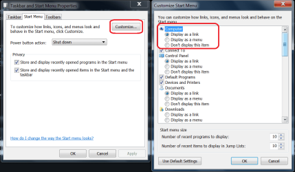

In the start menu search box I searched "Computer" and dragged and dropped it onto the main start menu. Now when I right click and select "Remove from list" it doesn't get removed.
The item isn't listed in:
C:\Users\username\AppData\Roaming\Microsoft\Internet Explorer\Quick Launch\User Pinned\StartMenu
I had "Don't show this item' selected in the start menu properties for "Computer", so I didn't realize I could have another way of displaying it prior to my putting it on the start menu.
I ran SFC and a new user account does the same thing.
James
Windows 7 64 bit
Hello James,
Could you post a screenshot showing this to help make sure if it's pinned to the Start Menu (above line), or just a recent program in the Start Menu (below line)?
If it's in the pinned to area, then it may just be a remnant registry entry causing it to still be listed even though it's not in the Start Menu folder in your post. You might give the tutorial below a try to completely reset the Start Menu pin to area to see if that will remove it for you.
http://www.sevenforums.com/tutorials/899-start-menu-reset-pin-area.html

I don't show recent programs.
The "Computer" I'm speaking of is not on the right. I dragged it to the left side.
I ran the batch file and it removed "Computer" and all my other Pinned items in the start menu.
No big deal, adding the 5 items back won't take long.
Thanks much for the batch file,
