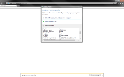

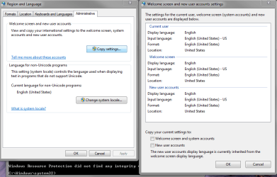

Ok, I will try and give the low down on whats going on without being too windy.
Last Oct, I had a hard drive take a crap on me, long story short, I have a somewhat fresh install of my OS Windows 7 pro. After I finished the installation and the updating of the OS, I moved on to installing all of my old software and files to my new fresh installation. This is where I noticed that I was having issues. I am stuck with IE8. When I try to update to either IE10 or IE11, I get major issues.

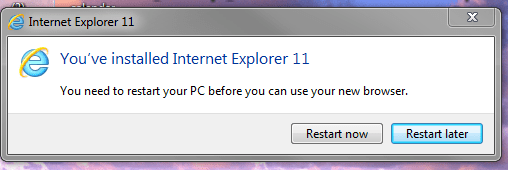

When I completed the upgrade to IE11(all websites are now warning me that im at risk and outdated) I noticed a very slow loadup time and other programs were not opening. When I would open IE11, it would just sit there and think and basically not allow me to do anything. As soon as I click on something, boom, IE shows up as not responding and I have to force it closed. After I force it closed, I try to open the Event Viewer and get an error stating that it cant be started, same thing, not responding. Then I went into services, that too was not working and not responding. I quickly uninstalled the update and reverted my changes and after a reboot, the old trusted and true IE8 was back and all was good with the event viewer and services.
This is where it gets strange, I stopped messing with IE as I was getting frustrated, then I moved on to trying to install the GoPro Studio and Steam. Both of these programs installed without errors and then when I try to open the program nothing happens. The programs dont open, however I see that the process is running for everytime I open the program. Very Odd, Not sure if its related to the IE issue, but seems like it to me. I was able to get the GoPro Studio to work after downloading basically the oldest version I could find. Even though it works, I am unable to update to a newer version as when I try it does the same thing as I mentioned above.

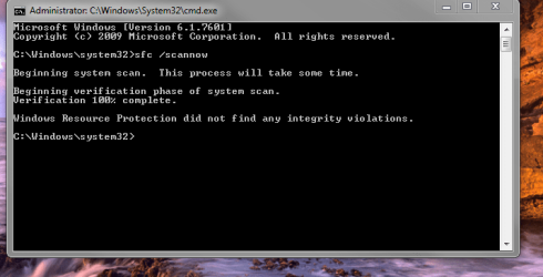

I searched and found some info regarding doing a SFC which I did and it came back clean(img attached)
I'm stumped and would love some ideas. I have tried tons of stuff so as you guys give me ideas/solutions I will give more info if I tried that or not. Oh and also, pc is clean from all of the scans I have done with my malware and virus protection.
My final thoughts are either this is a windows update issue or something to do with .net framework perhaps? I dont know anymore Ive lost hope so any suggestions or ideas would be greatly appreciated.
Thank you in advance
Justin

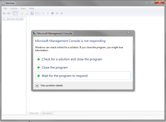

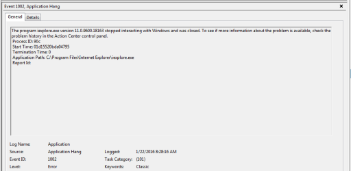

The first application hang lists mmc. I didn't know what that was so I went looking
What is MMC.exe and Why is it Running?
explains it and also says it should not be running if you don't have snap-ins.
Check what snap-ins are installed. Perhaps one of them is causing a problem.
IE 11 has had patches almost every month. Perhaps the hanging is due to looking for updates. My Win 7 computers (we have 4) have been very slow looking for updates yesterday and today. One was stuck at 100% CPU usage and I got so disgusted that I turned it off for several hours because I couldn't do anything on it.

Hmm..interesting...what I find odd about the MMC.exe is that I do not get this error/issue when I revert back to IE8 or if I dont open IE11 at all?

Hi Deadeye,
MMC is what loads multiple snap-in in your case the event viewer.
Are you sure the error is IE, not explorer.exe, they are 2 completely different things.
Anyway, in control panel > system is it showing service pack 1.
Can you run the prog in this link and we'll have a look if its an update problem.
http://www.sevenforums.com/windows-...ne-activation-issue-posting-instructions.html
(you should have at least 200 installed AFTER SP1).
Roy

For the record, I am not a newbie and anyone can throw anything at me to try at this point and I will give it a whirl. I have been working/coding/building computers since my first computer (TANDY 1000) dont laugh..I had big speaks and even saved up enough money to buy a HUGE 10MB hard drive! (i was like 9)LOL :geek:
actually this is a first for me even asking for help. I actually have never run into an issue that I was not able to troubleshoot and resolve on my own. So I am truly grateful for all of the help so far and whatever other help in the future. I have been a long time lurker here so it took a lot for me to register!:zip:
Ok, Just to be clear, I do not have any issues with the MMC until I restart my system after installing the upgrade to IE10 or IE11. Once I install that upgrade, I get lots of errors and nothing will load in the browser. It will just sit there and spin the circle on the homepage tab and do nothing until I try to close it out, which at that point I will get the not responding message and just task manager force it closed. Once I revert the change in browser back to IE8, the problem goes away.
If you need any other system information or screenshots I can provide those as well.
I appreciate the help and ideas though..keep em coming, this is driving me nuts!!

Well according to that report you have not registerd that comp.
follow this MS link
Roy

no more updates
Up to you,
But as i said you need to install KB971033.
Other wise the errors in the copy of your MGAdiag, will NOT allow updates

Ok, I have installed and corrected the registration issue. Should I now try to run the update for IE11 now ? Or you have some other things to check first?

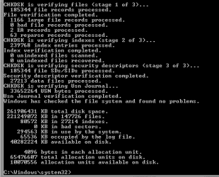

You could try running SFC /scannow, from an elevated command mode, and chkdsk.
Then reboot.
see if you can open the event viewer

Well I followed the steps that were suggested and as soon as I was done, It acted the exact same way. I opened IE11 and it just sits there and thinks (see screen shots) Then when I try to check the event viewer to see what is new, I get the error on loading the MMC. Again I reverted back to IE8 and everything worked correctly!
Im baffled and sooo frustrated....any other reports/logs you all need?

Hi Jason,
In the screenshot you posted I would like to see the Keyboard & Language page, not Admin.
According to the CBS log there are pending SXS files that cannot be deleted.
I have a way to do it, but id like to see that K&L page first.
Roy
