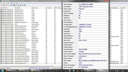

I am trying to plug in and use my USB midi controller, Akai's MPD32. It should just plug in and work, no drivers to install, just simple plug and play. It used to work but something is not working now.

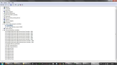

When it is plugged in I don't see the device icon in the tray but I can see it in Device Manager and Devices & Printers, both say it is working properly although it is listed as an audio device, which I don't know is how it should be as it is a midi controller, no audio is used. The device has power to it as well.
However, when I try to do anything with it I get errors. There is an editor specially made for this controller called Vyzex. When I try to use this it says:

I have no idea what is using the driver or USB ports. I have tried all ports. I used USBDeview to see what was being used and there is a "USB Composite Device" in use but I have no idea what this is, there is nothing plugged in. I have attached a screenshot of this with the device details in case this helps.

First, it's normal for USB controllers to be seen as an audio device.
Looks like you have multiple instances of the generic driver loaded. Not sure why unless it's been plugged into more than one USB port or a hub.

I captured your screen grab and marked what looks to be multiple devices, I'm guessing you finally had one to many USB devices loaded for the Akai and Windows finally became confused and for some reason has kept one loaded.
