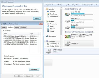

Now here comes the strange part: When plugging in my usb mobile broadband modem it installs correctly from the plug n play and says it's ok. But when I try to access it I get "windows can't access this disc". The modem works fine on my laptop so I know it's good. Got the same result with another broadband dongle.

In device manager the dongle shows up on DVD/CD-ROM drives as HUAWEI Mass Storage USB Device In the Universal Serial Bus Controller: HUAWEI Mobile Connect - Bus Enumerate Device
In safe-mode I can see two disks coming form the dongle in "Computer" - "Devices" one "Removable disk" and one "DVD/CD-Rom drive"

The 3g dongle shows up on "devices and printers" and checking properties -> harwardware all devices are "working properly" But NOT on Network Adapters as it did before I reinstalled Win7
