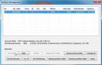

Following advice from SIW2 I looked at the link to the Dell problem he recommended. The solution there was to make the primary boot device '#1 <USB media name>', secondary '#2 <Other media>', etc.; unfortunately the BIOS on the Optiplex presents the user with pre-defined and uneditable boot media names, so this interesting approach was a non-starter.
However, the BIOS does have a facility to make a boot device 'dormant' - Dell's terminology, not mine - so I did this for all boot devices except 'USB Device'. Result was a slightly different error message:
No boot device available
Strike F1 to retry boot, F2 for setup utility
Press F5 for onboard diagnostics
Because I am uncertain about whether it is my preparation of the bootable USB stick, or the USB sub-system on the Optiplex, I borrowed a USB DVD/CD reader writer. Hooked this up on the target machine - currently 32 bit Win XP with SP3 - to the same USB port that I was using to try and boot from a stick. Then I set the OS to boot from a USB DVD/CD, put a Win 7 system disk in the drive and attempted to boot into the loading phase of the OS. This worked fine, so I concluded that the USB sub-system is OK as regards booting from a DVD/CD, in so far as it would boot when pointed at a USB DVD/CD device.
I downloaded SIW2's suggested utility in bootice.zip. Unpacked it and ran it to update the MBR on the stick containing the standard Win PE boot.wim, this time on the technician machine (Win 7 Pro). Moved it to the target machine, reset the BIOS to boot from a USB device, but again failed with the same error message.
Next I intend using the Bootice that SIW2 recommended in sector edit mode to look at the first sector of the file system, as this is where I understand the boot bits are set. I will do this after a disk format, again after I have refreshed the MBR with Bootice, and lastly after I have gone through the process of creating the bootable stick with Win PE on it.
Does anybody in the community have (a) a bootable USB stick that works, and (b) a disk editor, that they could use to let me have a file containing hex data? I understand that only the first three bytes are absolutely required, but if any body has the first 446 bytes off a bootable stick as a file that could be sent to me, I would be VERY grateful.

Hello all (again!)
Just reporting the latest work carried out.
1. Using Bootice as recommended by SIW2, I took a USB memory stick that I could read to and write from. Went to the elevated command prompt, entered diskpart and cleaned the USB stick. Exited diskpart and cmd. Started Bootice and went to sector edit. This screen shows the first sector with the master boot record (MBR).
Did a screen print, put the screen print into Paint, saved as a .png. Moved to PS Elements and cropped the screen print to the essentials, then produced a hard copy on a printer.
2. I then went back to the elevated cmd prompt and diskpart, and formatted the USB stick FAT 32, exited out again and ran Bootice. The sector edit screen was grabbed as before and processed to produce a hard copy. The hard copy was identical to that produced in 1 above.
3. Then I went back to to Bootice and looked at the machine's HD. Repeated the screen grab.
4. On comparison I found the following:
(a) the screen grabs from the USB stick have no data i.e a load of zeroes, between 0x01b8 and 0x01fd.
(b) the terminating signature at 0x1fe and 0x01ff are correct on all screen grabs as '55 aa'.
(c) the screen grab from the hard disk has 56 bytes of data from 0x01b8 and 0x1ef.
(d) the screen grab from the hard disk has, at 0x01be, an entry 80, which I believe to be the boot
indicator. This is the byte that indicates the volume is the active partition for booting.
(e) the values 80 does not appear in any of the offsets for the four allowed partitions.
Conclusion: despite following the USB preparation instructions, it would appear that no data to indicate the USB is active has been inserted into the MBR of the USB stick.
I think I could edit this MBR value in using Bootice, but I am unsure about what other data is required for the 16 bytes of a partition table for a USB.
Are there any knowledgeable persons who can (a) comment on what I have done and the interpretation or (b) let me have the correct partition table entry for a USB?

I've no experience creating bootable PE media on flash drives, but you've asked some specific questions I can help with. Although I avoid diskpart like the plague, it sounds like you don't have a partition on the flash drive. Did you create a primary partition first before trying to format it FAT32? (It may sound pedantic, but you don't format flash drives or hard drives, you format partitions.)
You haven't posted a screenshot, but I'll use SIW2's screenshot for reference. The bytes from 0000h-01B8h are the MBR boot code. It's only necessary if the device is meant to be bootable. Assorted Windows versions used slight variations on the MBR boot code. The 65 6D at 01B0h is indicative of boot code created by Win7's diskpart. Vista put the same 65 6D at 01AFh, while 2000/XP put it at 0179h. Not that it really matters, though, because they're all meant to do the same thing: find the active partition, load it's first sector into RAM, and redirect the CPU's instruction counter to that RAM location to pickup the instructions for loading whatever particular OS on that partition.
The four bytes from 01B8h-01BBh are the DiskID, and meant to uniquely identify each disk in Windows. Therefore, they should not be the same as any other disk in your system, and should not be zero. I believe Disk Management's "Initialize disk" procedure is supposed to create a random DiskID if it's not present, but you can also create a DiskID manually by putting in there any random values you wish. (I have a habit of using the DiskID to help identify my disks when I'm mucking around in a sector editor, so I use IDs like "250G" or "WD1T", and such.)
The partition table consists of four partition descriptors, 16 bytes each, spanning 01BEh-01FDh. A first byte of 80h indicates the "active" partition, and the other three descriptors must be 00h.
The next 15 bytes of each descriptor define the partition. If you said you've got all zeroes there, then no partition has been created. I never use diskpart, but I would think it ought to prompt you to create a partition before trying to format it, doesn't it?
Those 15 bytes are divided into groups of 3/1/3/4/4 bytes. The first and third groups are the beginning and ending sector locations of the partition, bit-encoded in the old fashioned cylinder-head-sector scheme. The fourth and fifth groups are the same partition defined as starting LBA sector number and total number of sectors in the partition. The second group is a single byte indicating the type (format) of the partition's file system (07h for NTFS, 0Bh or 0Ch for FAT32, etc.)
Now, of course, if you and SIW2 have different disks your values may be different, but chances are most values could be the same. Your partition-type byte will be 07h if NTFS, and the starting-location values are probably the same. In SIW2's example, 20-21-00 and 00-08-00-00 both mean LBA sector 2048, the usual starting sector for a standard MB-aligned partition in Vista/7/10. (Tip: the LBA numbers are stored in little-endian fashion, so 2048 is 00000800h. Similarly, the size of SIW2's partition is 03b5f800h, or 62257152 sectors.)
The old C-H-S scheme maxed out at 8GB, so if your flash drive is larger than 8GB the third group (ending CHS location) will be "pegged" at FE-FF-FF, it's maximum value, regardless of how much larger it actually is.
Hope this helps you interpret what you're looking at. It sounds like your immediate issue is to create a partition before formatting it and installing the PE stuff to it. As I said, my experience is too limited to direct you how to do that, but hopefully this info helps point you in the right direction.

More learning from JohnPat
Hello all
Think that, without the help received here I would be still working on this at Christmas. However, one of the targets I initially set myself - see first post under Software - was to learn more about the Win 7 ecosystem. Don't know if this will help other newbies like me, but should be very familiar to the experts.
Above we see what happens after the clean command. If there were partition tables in the first 446 bytes, they have all been zeroed.
After creating the primary partition (above), 0x01bf to 0x01cd are filled with partition table data.
It is the active command (above) that makes the partition bootable - the nibble at 0x01b8 now contains 80.
The format command doesn't change the range 0x01be to 0x01cd.......
..and neither dies the assign command.......
...or the loading of the bootmgr by means of bootsect.exe
So..onwards and upwards to Win PE.
Hope this helps newbies like me.
