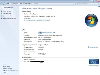

At this time there is nothing wrong with my drive or OS(7) but my machine seems to be short on power for running my CAD/CAM programming. Screen will lock up and churn fora bit, then take off and run. I have 4g memory, but it says it only recognizes 3.5g. Fellow machinist running same program said I need a better graphics card and more CPU power, so the search is on. I do not wish to start over from scratch with my programs and would simply love to just put my drive into a new computer, either buy a barebones or store the takeout drive.
I tried this once before with another 7 machine I have and it would not boot and run, return original drive and it was happy again.
Can this be done without investing in some expensive, time consuming data transfer program?
compaq
7 home premium 32 bit
AMD Athlon LE1640
2g

I assume that CPU you have is an AMD Sempron LE-1640.
It's quite puny, scoring 759 on the Passmark CPU benchmark.
By way of comparison, a mid level machine from around 2010 would score 4,000 to 6,000.
I'm wondering how old that PC is?

Maybe you could post a snip of your WEI ( Windows Experience Index ) now so we have an idea of what you have.
Example of my Gateway GT5404 heavily updated without the ssd, just a Seagate hard drive.
