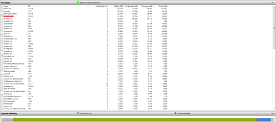

Very high physical memory usage with nothing open
Lozy
9:13 PM
2
msconfig - disable all 3rd party software startups
ramMap, file explorer, nothing looks fishy
scanned system with ESET, malwarebytes, hitman
clean system with advanced system care and CC cleaner.
nothing helps a bit
just cant figure out what is eating up my rams, have been trying to solve this issue for almost one month then i decided to start a thread. what actually could the the problem here or did i misunderstood how physical memory works ?

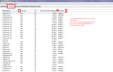

Hello and welcome Lozy mate first right click anywhere on your taskbar and click Start Task Manager you will get a screen / windows come up like my pic this will show you what is using RAM. Max the screen and hover over where I have indicated to let you see more detail - usually the big users of RAM are listed first.
You will see even with only 8GB of RAM my lappy is not using much at all. A pic of yours would be good
see these http://www.sevenforums.com/tutorials/9733-screenshots-files-upload-post-seven-forums.html
and
How to Use the Snipping Tool in Vista
