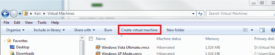

Put the vhd in C:\Users\Your_Username\AppData\Local\Microsoft\Windows Virtual PC\Virtual Machines
Go to C:\Users\Your_Username\Virtual Machines, click Create virtual machine.

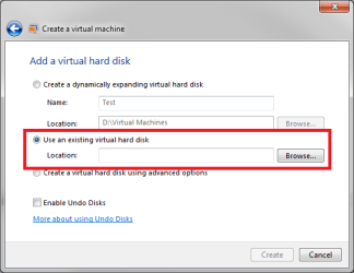

In next dialog you can first name your new VM and allocate certain amount of RAM to it. After these two steps you are asked if you want to create a new virtual hard disk or use an existing one.
Select Use an existing virtual hard disk and browse to the vhd file you want to use.
