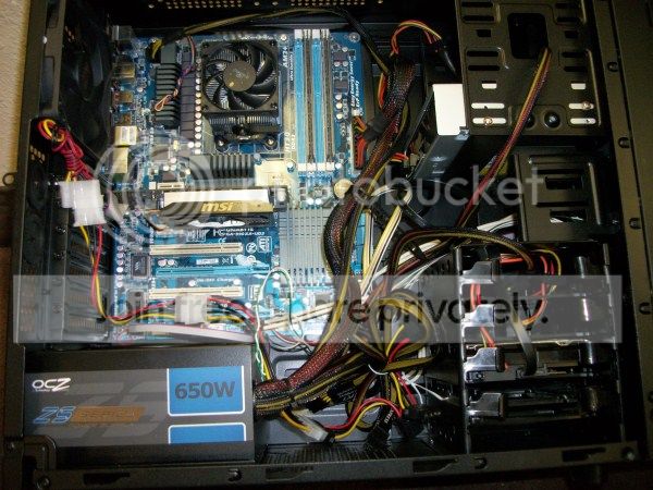

I have built many AMD based systems and in fact all of them until my most recent system are AMD. Bang for buck at the moment I like ASRock but have to admit that all the rest have been MSI mobo's. Right now AMD is blowing out the 1st generation 8150 8 core and that's what I would suggest, the rig you build will be a freak'n monster as is my 8120 rig that OC's to 4.7 and runs like a scalded ape!

am3 chips usually work in an am3+ board.
The main way of going about checking this is to find an AMD motherboard that you like and check online.
Example:my last AMD build I used an FX processor that takes AM3+ but it has support for a long list of cpu's
Newegg.com - GIGABYTE GA-990FXA-UD3 AM3+ AMD 990FX SATA 6Gb/s USB 3.0 ATX AMD Motherboard
first from newegg, I copied the brand name and model and search google.
Then went to Gigabytes page. GIGABYTE - Motherboard - Socket AM3+ - GA-990FXA-UD3 (rev. 1.0)
Here you can find more info than on newegg. On this page, there is usually a CPU support list and a supported Ram List
this will list all of the supported hardware and what bios version is needed.
GA-990FXA-UD3 (rev. 1.0) CPU List
Some boards that were AM3 have bios updates to support AM3+ chips. The actual pin layout is the same though so AM3 and AM3+ chips fit.
I went with the FX-6200 6-core processor and it is awesome.
Things to take into consideration when picking out motherboard:
Are you going to be using a dedicated graphics card or do you want integrated graphics. boards without integrated graphics will require a graphics card.
Are you planning on using multiple graphics cards. some boards don't support SLI or Crossfire...
Are you planning on overclocking. some boards are better than others for overclocking offering easy bios overclocking settings and multiple bios to revert changes easily.

I have built about 20 AMD & Gigabyte MB combo in the past 2 years.
Just built this a few weeks ago ;)
