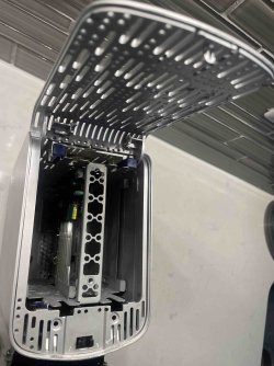

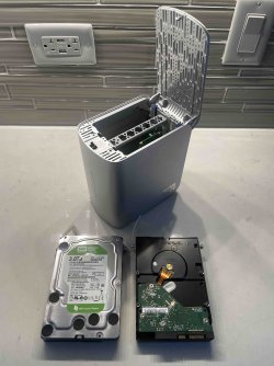

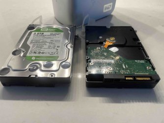

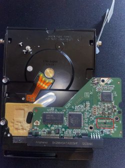

Hello, this is my 1st post and the reason why I joined. I have a water-damaged hard drive 6TB that had water on-or-in it for 1 day and then I dried it out. I see no water corrosion damage anywhere on the drive itself or the internal control board in the chassis or housing.
This hard drive will power up for 10 seconds and has the front light blinking but no spinning of the platters when plugged into any computer using the same stock AC adapter.
I read that it could be a problem with the control board in the housing unit and to use a SATA-USB connector straight into the computer which I've done to no avail. I've tried this 3.3V pin tape-hack explained in Step 14 here -
How to Shuck a WD Elements External Hard Drive - iFixit Repair Guide
...and still nothing on both drives. I don't know what else I can do which is why I'm asking you. Some extra links to the exact model I have with the online manual and attached photos. Any advice is greatly appreciated, thank you.

Since there are 2 drives the enclosure had to do a special kind of setup known as a raid. That can put 2 or more hard drives together and makes them look like one drive. That's why you can't see anything on the drives because you haven't recreated the raid set up. Look for raid in your bios settings and check your computer's manual. If there are no raid settings you'll need to get an external enclosure with raid built-in such as ones here: Just a moment...
This set up is only raid 0 (as confirmed by one of your links and the manual) and I would never use raid 0 since if you lose either drive you lose everything on both drives. If you can get the data back I would use the drives as single drives and not a single volume raid for that reason.
