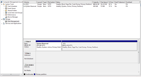

When I click on the "Disk Management" option I can see the external disk on the bottom half of the screen on the right hand side. On the top half it only shows the local disk (C:\) but on the bottom half I can see my local disk and I can see that it has detected my external disk. The external disk is picked up as "Disk 1", there is a small red arrow pointing downwards on the image of the disk. Below the disk image it says "Unknown" and below that it says "Not Initialized". Unlike my local disk, it does not recognize any information about my external drive.
When I right click this with my mouse I get the following 4 options:
1. Initialize disk
2. Offline
3. Properties
4. Help
If I select the option to initialize it it gives me an option to select either MBR or GPT. I have tried selecting both methods and I get the same error message which reads "The device is not ready". If I select the second option I get the same error message which reads "The device is not ready".

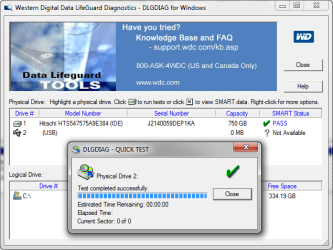

Also, did you run any diagnostics to see what the health of the drive is? If yes - what were the results? If not, you can download and use Data Lifeguard Diagnostics and see if the program will find any errors/bad sectors on the HDD:

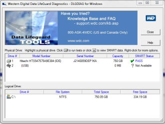

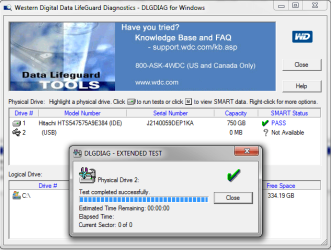

@MightyMiroWD - I did actually download the Data Lifeguard Diagnotics and ran that to test using that. I only ran the first two tests and both tests took about a second to complete. I know that the second test should take longer than that. Also, the diagnostic tool detected that it was a USB drive but it picked it up as 0.00GB in size which is why both tests took about a second each and it passed both which is also not correct. I have just got into work and so not able to take any screenshots but I will do so and attach them when I get home tonight. Stupidly last night I could not see the attach button to add photos so did not attach photos with my original post. Now that I have worked out where the attach button is, I will add photos later tonight.

I have attached four screenshots to show what I am seeing:
1. This shows the Disk Management screen and as you can see on the bottom right it has been picked up as "Disk 1" but no other information has been picked up.

3. This is the WD Diagnostic tool main screen and you can see it has picked up a USB drive but no other information.
4. This shows that a quick test passed but it's not accurate.
5. This shows that an extended test passed but again this is not accurate either.
