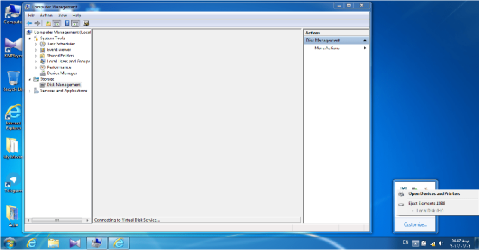

Is this the way you are trying to get to Disk Management?
Start Orb
Right tick on Computer and select Manage then select Disk Management which is under Storage
And when I first open Diskmgmt then connect hard

Layback Bear First I opened DiskManagement then connected Hard.
as you see it's "Not Responding" .

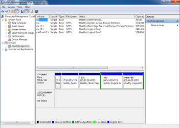

it's disk management status

Well now that is strange. I can understand not seeing the external drive but I don't understand not seeing any drives.
Is that the exact same way it acted on the other computer?
Once again. Are you using the 12 volt connection on your external drive??

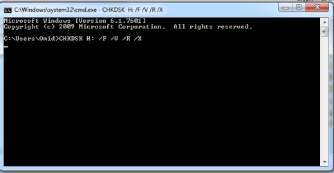

Hi. guys everything is normal but check disk doesn't strat !
I typed checkdisk command and waited for 9 hours. it didn't start.

Did you press the ENTER Key after typing the command?
