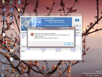

Hi all,
I was wondering if you could provide me with some feedback on a hard drive issue that started when I booted up my pc yesterday. Hard Drive is WD 160GB SATA.
I received this error at boot up:
Read Disk Error CTRL+ALT+DEL to restart
I restarted and luckily I was able to get to the desktop (took longer then normal tho).
Checked Event Viewer.. nothing showed. Checked Performance Logs... no errors showed.
Decided to double check all the connections... all plugged in nice and secure. Rebooted. Got the Read Disk Error again. this time it took me 3x to get to desktop. I decided to try another SATA connection on motherboard. REbooted.... got error again.
I ran a chkdsk/r and when system rebooted the Read Disk error showed up again.
After another 3 ctrl+alt+del reboots... I was able to get into Windows. I downloaded the Diagnostic Tools from WD and my drive failed both the Quick and Extended Tests. Not surprising lol
Anyhoo, here is a screenshot of my WD Diagnostic test results. I was wondering if it was a HDD issue or a motherboard issue? Any thoughts? I would rather replace a HDD then a motherboard. This WD 160 SATA drive is less then a month old also. BIOS sees the hard drive.also tried setting BIOS back to default.... sometimes that works but not this time tho :-(
I think I am living on borrowed time with this HD but before I replace I wanted to get more opnions.

Did you create the bootable CD ? ?
The results are more accurate then running it inside Windows.
Also you should be running the Long test.

Did you try swapping the sata cable itself? I recently had a HD that failed to boot because of a dodgy cable.
+1 outside Windows and Long test.

Stupid question from me:
Is SMART enabled in the bios? worth a check.

I did a quick and a long test.... I also used bootable CD and failed all tests. I thought about swapping out SATA cables... havent tried that yet. Luckily I had a Seagate SATA HD to use. No Read Disk errors with this one yet. SMART is disabled in BIOS. (BIOS default) should I enable it??
The error says it failed because SMART did not start.. so yes.

hi all,
just an update:
I swapped out SATA cables and computer booted with no errors. I decided to test both SATA cables and HDD.
I installed XP on the 160GB drive and used the SATa cable that came with my Seagate... no errors during install... XP booted up great. So I decided to swap SATA cables again and no errors at all and quick boots! So I am unsure if my WD 160 GB HDD is actually defective. Maybe I had corrupt Windows 7 files because XP installed and booted several times with no issues. either way, system up and running with minimal issues. Windows 7 boots up and runs great on the Seagate 500Gb so if it aint broke don't fix it lol
