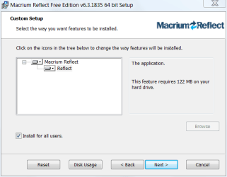

I don't know what to choose when Installing Macrium, there are two choices.

I chose the Second one "Reflect" for the Install Software Options, hope that was correct.

Did I mess up by Choosing "Reflect" for the Install? The first choice was asking about Installing some Web based tools that I did not think I needed.

It didn't matter it still installed the program and you should create the rescue disk or usb stick with WinPE that should be the default if on windows. Set for multi boot MBR/UEFI. The BIOS will have to be set to CD/DVD or USB as first boot option depending which you chose.

billmcct, thanks! I will create the disk and move on. I'm pretty sure the choice I made was good but I can't be positive. I think it was to use the tool over the Network, which I don't need. AOMEI was very simple to use over this so far, but I could have just installed the default, so that's on me if it doesn't work.

It will work.

I never have selected anything but Next :)
