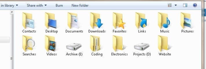

By way of agreeing with Bill2...
I always partition my drives... My main workstation looks like this...
The reason for this is that should anything happen in the system drive, the chances of my Data and Archive drives being affected is quite low. But you need a way to conveniently access these drives...
The Archive drive is simple... I just made a desktop link for it and manage the files there manually.

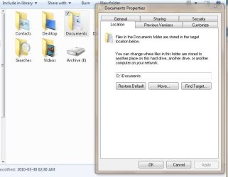

The Data drive is a wee bit more complicated. What I did there was to make the folders I needed (Music, Video, Pictures, Electronics, Programming, etc.) and then I relocated the "My Whatever" folders from my user account to the data drive...
Next I Dragged my username out of the start menu and onto the desktop, which creates a shortcut to my home folder. In that folder I also created extra shortcuts to the various folders that were not "My Whatever" and I use my home folder as a launch point for the entire system....
The joy of this is, as Bill2 points out, that you have a very easily managed system, with tons of space available and far easier maintenance. I use an external HDD to backup my files with Robocopy, which only copies changed files. My Projects disk is changing all the time as I work on this and that... The archive disk almost never changes except to add new stuff to it. Backup and defrag are something of a non-event on a system like this.
