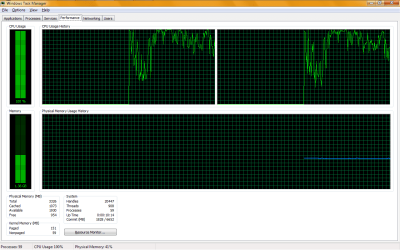

ive gotten rid of all bloatware i could find, this install is clean, all drivers are up to date. i figured out its not the HDD, its the CPU, with NO TASKS RUNNING AT ALL, just base windows with no programs running, cpu usage NEVER goes below 98%. i can not find the cpu hogger no matter what i do. its SO annoying. got any ideas?

it used to run at 170 oF and it didnt step the cpu down. i put a different cooler on it and arctic silver 5, now it runs 122 oF. so its way cooler, i dont tink cpu is being stepped down. its a task killing it. i was in process explorer and there was something called "interrupter" taking 48% of the cpu. i tried to end it, but it says invalid parameter. heres a screen shot of Windows task manager, and this is all the time, not just for the screenshot.

Did you use Process Monitor from Step 12 of Troubleshooting Steps for Windows 7
to zero in on the offending Service? There is even a video given in the same step to demonstrate it.
We don't know what steps you've completed until you start working through them with feedback. Not interacting fully with the steps is normally assumed to be laziness or at least a lack of thoroughness that means the problem won't get solved. We're not going to spoon feed everything when very explicit steps complete with video tutorials are just ignored.

i looked at that list, went through with process explorer, and i also did some disabling in device manager (drivers i newly installed i thought were causing issues, and they were), now cpu usage is not even close to what it used to be. but now my video and sound is still slow and clicky/skippy and distorted.

i did the troubleshooting, went through device manager while latency checker was running, and i found out if i roll back my driver for "Intel PRO/Wireless Network Connection" which i think is my wireless internet chip , and the latency went from 6000 to 1900. so i guess the issue was the newer driver. The driver installed was from 2010, now rolled back, 2008, and works just as well, but latency is way better (i dont care how old the driver is, as long as it works best :-) ). i went through other things that have to do with Bluetooth and network, and nothing else changed the latency, yet when i turn all wireless connections off (i have a switch on the side of my laptop that turns off ALL wireless connectivity), latency goes down to 500, and maxes out at 1200. but its WAYYY better than it was. ive updated all software i have installed, did clean boot, (i do that anyway, no need for all the extra stuff at bootup), and i constantly monitor my temperatures, CPU cores never goes above 170 oF, if they do, its when im working it brutally hard. usually hovers between 119oF and 131oF.
