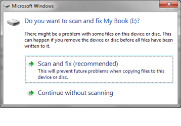

I have a 2 TB Western Digital (WD) HDD My book (WDBFJK0020HBK-NESN) connected to my laptop for backups. Every time my laptop wakes up (Dell 6510, W7 HP) and detects the WD HDD, I get a pop-up window that asks me " "Do you want to scan and fix My Book?". Windows believes that there are some corrupted files in the WD external HDD. I have other external drives but none of them have this issue. The problem is unaffected by the other drives being present or not. I tried and that doesn't matter.
The WD drive behaves normally: It can be found in the task manager and in the Windows explorer just fine. I have used it for backups with Macrium and W7 native utility w/o errors. The files I retrieved from it for testing purposes are fine. I can navigate, everything looks ok.
BUT I get that pop-up every time! I think this happened since day one or very shortly after I started using the My Book.
The driver for the disk is up to date. My fear is that one day I will click "Yes, scan and fix" by mistake and I will erase everything I have in the HDD. I never installed the Western Digital "SmartWare" or -God forbid- the Acronis lite SW shipped w/the drive. I just plugged it in, watch W7 find the driver and used it basically as a giant USB stick...
Because I don't use the WD software, their site is useless to help w/this; but I read strong recommendations here against mucking up the communication with the external disks w/those unnecessary layers of SW control.
Q1- How can I tell if my drive really has problems w/o installing the WD software?
Q2- Could it be that W7 is spooked by the Macrium image files which are in Macrium's propitiatory format which may make Windows 7 think they are unreadable?
Q3- Would installing WD's SmartWare software (which has diagnostics in it) mess up the backup image files in the drive?
Q4- Am I doing the right thing by saying to Windows "Continue without scanning" when it asks me to let it repair My Book? It doesn't seem broken so I don't understand what's going on...
Any thoughts would be greatly appreciated!!

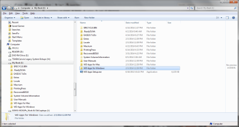

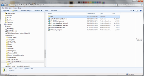

I'm attaching here screenshots of:
- The top level folder in the WD Mybook
- The "WD apps for Windows" sub-folder
My goal is to install the WD diagnostic tools w/o also loading all the bloatware. I'm guessing that executing the "WDDriveUtilitiesSetup.exe" would do that, but I'm not sure...any thoughts?

That popup appears to be from Windows, not from any WD software. My guess is that if you said yes, it would run CHKDSK---which is usually harmless enough.

That type of Windows message may appear, if the device was not properly disconnected. Windows assumes that you may have some errors on the drive and that's why is proposing to scan. That message is unlikely to be related with any file format or software. It is not likely to lose any data if you click “Scan”, but there is a chance to see the message again. Generally you can disable this kind of messages but it is not recommended, because that way you may lose other Windows features, related with AutoRun.
You can check the drive for errors from Windows 7 Explorer or with the chkdsk [drive]: /r command from the command prompt (see links below). This is a standard check for the connected drives, but I highly recommend you to use the Data Lifeguard Diagnostics (DLG) tool, which is provided by Western Digital. Run it and scan the drive for some errors.
Have you experienced any issues with WD SmartWare? All WD products are meant to be used with their software. That is why I advise you to use the WD SmartWare for backups, which will handle the transition of the files between the internal drives and the external. It is highly used with all WD external products. You can update the software directly from WD web site and get support. All your previous backups will remain in the My Book.
Of course, if you prefer to use another software, go for it. You can download the Data Lifeguard Diagnostic, without the SmartWare, from the link, provided below.
If your device is working fine, you can keep clicking “Continue without scanning” every time you see the message.
