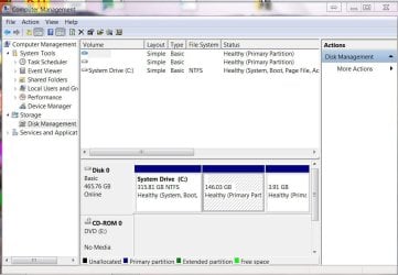

I have an external disk which I use for my backups. I deleted a couple of Ubuntu partitions and in the process I think I saw something about a missing drive letter. I was clicking things too fast and by the time the missing drive letter registered in my brain it was too late.
Now when I go to disk management I don't see Drive 0. I plug and unplug the USB cable to the backup disk and get an audible signal that indicates connect and disconnect of the drive or maybe just the drivers.
I'm attaching a screen shot of what I see in disk management. As soon as I am able to get another external drive I will confirm that the problem isn't the drive.
What can I do in the meantime?

Have you tried hooking the external to another computer to see if it comes up ok ?
How many drives are hooked up NOT INCLUDING the external ?
Can you give us a shot of disk management from Windows 7 ?

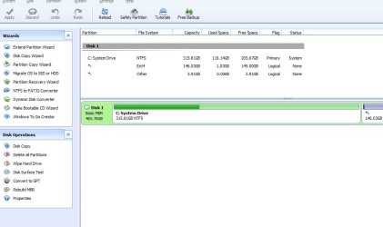

After my last post I found an old external disk in my closet. Hooked it up and it was recognized. The original Drive 1 (system W7) had changed to Drive 0 and the external to Drive 1. I removed the external drive and the system drive remained as Drive 0.
My final analyisi is that the external drive with my backups is faulty. On Wednesday I will take it to the shop to troubleshoot further. Attached is the W7 screen shot.

Bill it could of been the 3rd party program you use for disk management.
Some times they will read the drive # different than Windows.
That is why you must be careful when using some 3rd party disk management programs.
You can format or other things to a drive #1 using a 3rd party program when in Windows it's actually drive #0 you just made changes to.
So it seems you`re all good now ;)
If you give that 146 GB partition a letter, you could start using it for data storage.
