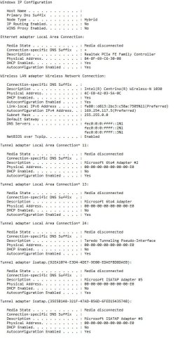

Help, please. I have a laptop that shows the yellow triangle on the WiFi tray icon. Other devices can connect to the same router without issues.
1) I tried using a wired connection with no success in connecting to the internet.
2) I tested the hardware using Ubuntu LiveUSB and was successful in connecting the laptop to the router.
Below is the output from ipconfig /all is attached.

In Device Manager, there are no yellow marks. I installed the latest device driver for the wireless "Intel(R) Centrino(R) Wireless-N-1030" This did not fix the connection problem.
I also tried doing the manual WinSockFix commands that were here (Nothing found for En-us Winsock-fix-for-windows-7 ):
netsh winsock reset catalog
netsh int ip reset reset.log hit
REBOOT PC
This WinSockFix did not restore the internet connectivity.
1) I get a successful reply from pinging 127.0.0.1.
2) I get a successful reply from pinging the laptop's Autoconfiguration IPv4 Address: 169.254.117.5
Unfortunately, this IP address should be 192.168.x.x
3) I do NOT get a successful reply from the Default Gateway (router's IP address).
I can get a successful reply from pinging the router's IP address if I manually configure the "Internet Protocol Version 4" with a private IP address (192.168.1.50) and put in the router's IP address as the gateway and Preferred DNS Server. Unfortunately, while I can now ping the router, and the IP address associated with Google(216.58.219.238) I cannot open the Google URL in any browser. But if I type in the IP address 216.58.219.238, the Google website is displayed. Also the yellow triangle "No Internet Access" is now gone. Do it would seem that the DNS server is not happy.
Configuring the IPv4 addresses manually is not ideal and worse still, when I reboot the laptop, the connection is again not working.

Windows IP Configuration
Host Name . . . . . . . . . . . . : DellN4110
Primary Dns Suffix . . . . . . . :
Node Type . . . . . . . . . . . . : Hybrid
IP Routing Enabled. . . . . . . . : No
WINS Proxy Enabled. . . . . . . . : No
Ethernet adapter Local Area Connection:
Media State . . . . . . . . . . . : Media disconnected
Connection-specific DNS Suffix . :
Description . . . . . . . . . . . : Realtek PCIe FE Family Controller
Physical Address. . . . . . . . . : 84-8F-69-C6-30-08
DHCP Enabled. . . . . . . . . . . : Yes
Autoconfiguration Enabled . . . . : Yes
Wireless LAN adapter Wireless Network Connection 3:
Description . . . . . . . . . . . : Microsoft Virtual WiFi Miniport Adapter #2
Physical Address. . . . . . . . . : 4C-EB-42-03-5A-0D
Wireless LAN adapter Wireless Network Connection 2:
Wireless LAN adapter Wireless Network Connection:
Description . . . . . . . . . . . : Intel(R) Centrino(R) Wireless-N 1030
Physical Address. . . . . . . . . : 4C-EB-42-03-5A-0C
Autoconfiguration IPv4 Address. . : 169.254.167.93(Preferred)
Subnet Mask . . . . . . . . . . . : 255.255.0.0
Default Gateway . . . . . . . . . :
NetBIOS over Tcpip. . . . . . . . : Enabled
Ethernet adapter Bluetooth Network Connection:
Description . . . . . . . . . . . : Bluetooth Device (Personal Area Network)
Physical Address. . . . . . . . . : 4C-EB-42-03-5A-10
Tunnel adapter Local Area Connection* 11:
Description . . . . . . . . . . . : Microsoft 6to4 Adapter #2
Physical Address. . . . . . . . . : 00-00-00-00-00-00-00-E0
DHCP Enabled. . . . . . . . . . . : No
Tunnel adapter Local Area Connection* 13:
Tunnel adapter isatap.{6D107E97-2E04-4841-BD62-CCACB79BDCF4}:
Description . . . . . . . . . . . : Microsoft ISATAP Adapter #2
Tunnel adapter Local Area Connection* 24:
Description . . . . . . . . . . . : Teredo Tunneling Pseudo-Interface
Tunnel adapter isatap.{FEDC817D-6F1D-44DB-B8DC-81FD22ED262C}:
Description . . . . . . . . . . . : Microsoft ISATAP Adapter #4
Tunnel adapter isatap.{6F1C9361-1E22-4E56-90DC-D6E6604347E0}:
Description . . . . . . . . . . . : Microsoft ISATAP Adapter #5
Tunnel adapter isatap.{E05EA3C2-760B-411B-AAD1-96B42595C7B8}:
Description . . . . . . . . . . . : Microsoft ISATAP Adapter #6
Tunnel adapter isatap.{CE1D90F4-EF45-423F-BB5E-F112745556F6}:
Description . . . . . . . . . . . : Microsoft ISATAP Adapter #7
Ping request could not find host yahoo.com. Please check the name and try again.

I do not know why I could not connect to the Cable Model directly. It showed the same results as trying to connect to the router. I was able to connect another windows 7 laptop to the modem with no issues.
Dell Inspiron N4110
Windows 7 Home Premium, 64 bit
i3-2350M
Unknown
6Gb
IE and Firefox
Definitely shows no wired or Wireless connection.
You can try Uninstalling the Intel Wireless adapter from Device Manager, just right click and select Uninstall.
Do the same with the wired Lan device.
Reboot and let Windows 7 rediscover the devices and reload the drivers. see if that makes a difference. If no help then a Repair Install may be your best bet. Brink's tutorial is very good for this.
You mentioned reimage. Do you have a image backup? If so might be worth while trying the Repair Install first as that leaves most things intact. Reimage if that doesn't help.
