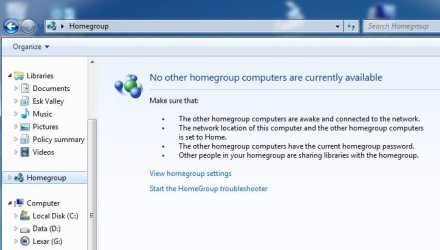

Once again in machine A neither machine shows up under the network icon in windows explorer, but machine B shows under the homegroup icon. However no folders are available when that icon is clicked on. In network and sharing centre when you ask for a full map machine B shows up but when you double click it won't open up any further.

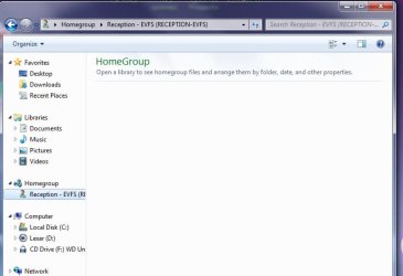

  • Machine A cannot see B and cannot access files on B. Correct but with the exception shown here:

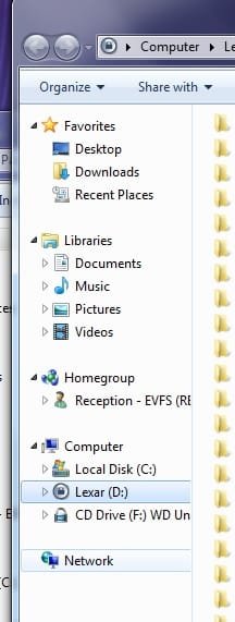

But curiously it doesn't show up under the network as shown below:

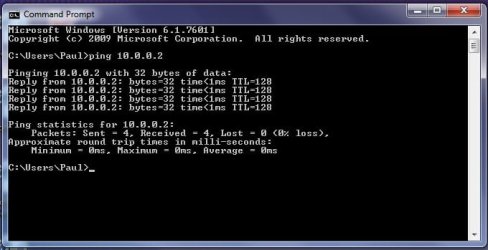

  • Are you able to ping machine Machine B with Machine A? Yes as shown here:

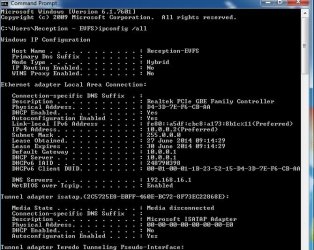

And now for Machine B:
  • Please post the ipconfig /all of Machine B here.

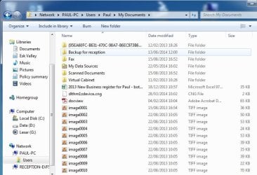

Was able to access the files on Machine A from machine B by double clicking on Machine A (Paul-PC) icon under network:

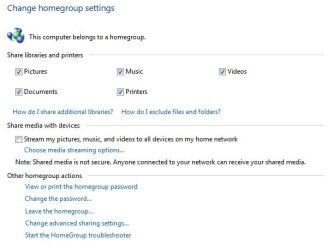

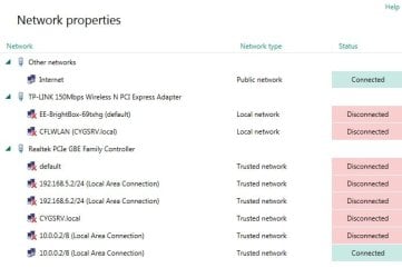

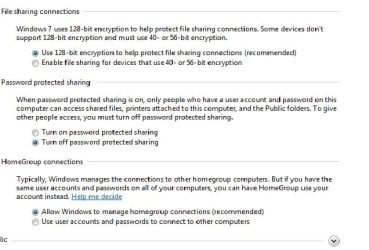

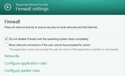

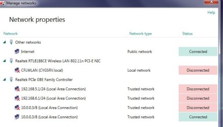

Well I changed the Hosts file on both machines and I'm afraid it made no difference. I am going to post some screen dumps off both machines.
Firstly Machine A (Paul-PC)

Now Machine B (Reception EVFS)
View attachment hosts Machine B.txt
Any ideas here on how to resolve this would be good. We are either thinking of doing a backup, re-install, and restore on Paul-PC (Machine A) or buy a new one, (Machine A is not a new machine, but Machine B is). Any other ideas would be welcome.
