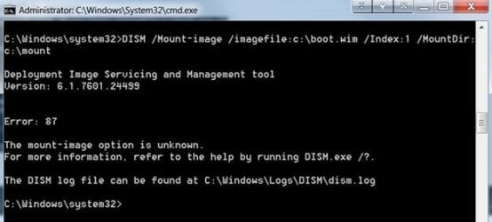

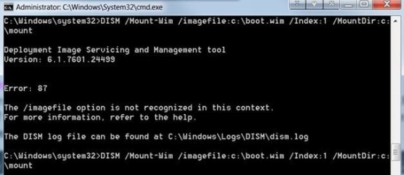

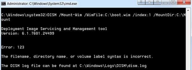

SIW2- I followed the steps you listed & received this error:
These are the options listed for DISM:
So I changed Mount-image to Mount-Wim & got this error:

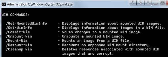

So, then I typed DISM /Mount-Wim /? to see this:

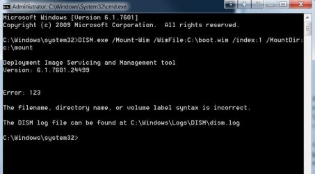

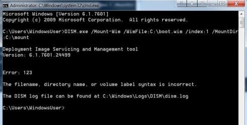

Based on that, I tried running their sample command:
Now, I am really tired, but I'm pretty sure I typed all that in correctly.
I'm more Confuselled than ever.
Did I go wrong with the /Mount-Wim command?
Should I just buy a Mac?
Any thoughts?
Best,
Sam
you were correct.
I forgot the commands for win7 are different and gave you the commands for newer versions of dism by mistake.
DISM.exe /Mount-Wim /WimFile:C:\boot.wim /index:1 /MountDir:C:\mount
should work if c:\boot.wim and c:\mount exist.

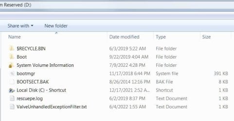

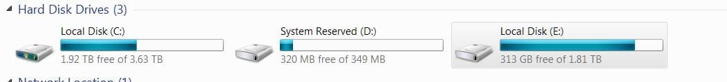

@SIW2- OK, I ran the command and now things are getting interesting or weird, or maybe both.
I received this error message:
I opened the log file and it appears the command is looking for my "D:" drive:
2022-09-17 23:45:31, Info DISM PID=3208 Scratch directory set to 'C:\Users\WINDOW~1\AppData\Local\Temp\'. - CDISMManager::put_ScratchDir
2022-09-17 23:45:31, Info DISM PID=3208 Successfully loaded the ImageSession at "C:\Windows\System32\Dism" - CDISMManager::LoadImageSession
2022-09-17 23:45:31, Info DISM DISM Provider Store: PID=3208 Found and Initialized the DISM Logger. - CDISMProviderStore::Internal_InitializeLogger
2022-09-17 23:45:31, Info DISM DISM Provider Store: PID=3208 Failed to get and initialize the PE Provider. Continuing by assuming that it is not a WinPE image. - CDISMProviderStore::Final_OnConnect

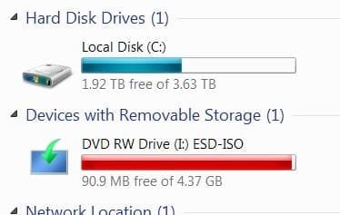

I do have a second hard drive in my PC, it's the original 2Tb hard drive that I replaced with the current 4Tb hard drive, but I unplugged it for the Win 10 upgrade. However, I think this was after a few attempts at running the Windows 10 upgrade.
Is it possible that my old hard drive has somehow been linked to the upgrade process?
For reference, here is a screenshot of my existing hard drive & the DVD containing the ISO:
Do you have any thoughts on what this mad PC of mine is doing?

@SIW2- Looking through my notes from when I upgraded to my current hard drive, I see that I did try cloning the old drive using Macrium, and I did create Rescue Media, but I ultimately ended up using Acronis because I needed to change the new drive from MBR to GPT so I could extend the partition after cloning.
I plugged my old hard drive in, booted my PC & this is what displays in Explorer:
Here are the contents of D:
I ran DSIM again, received this error:
Looking at the error long, I see pretty much the same thing as before, but with different PIDs:
2022-09-19 12:36:14, Error DISM DISM WIM Provider: PID=3056 Failed to mount the image. - CWimImageInfo::Mount(hr:0x8007007b)
2022-09-19 12:36:14, Error DISM DISM WIM Provider: PID=3056 d:\w7rtm\base\ntsetup\opktools\dism\providers\wimprovider\dll\wimmanager.cpp:999 - CWimManager::InternalOpMount(hr:0x8007007b)
2022-09-19 12:36:14, Error DISM DISM WIM Provider: PID=3056 d:\w7rtm\base\ntsetup\opktools\dism\providers\wimprovider\dll\wimmanager.cpp:2247 - CWimManager::InternalCmdMount(hr:0x8007007b)
2022-09-19 12:36:14, Error DISM DISM WIM Provider: PID=3056 Error executing command - CWimManager::InternalExecuteCmd(hr:0x8007007b)
2022-09-19 12:36:14, Error DISM DISM WIM Provider: PID=3056 d:\w7rtm\base\ntsetup\opktools\dism\providers\wimprovider\dll\wimmanager.cpp:516 - CWimManager::ExecuteCmdLine(hr:0x8007007b)
I don't see any sign of folder w7rtm on either D: or E:
