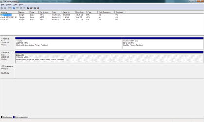

The disc management screenie is attached
Its a laptop, out of warranty, and I am a bit hesitant to open it up. Both drives are SATA. And when win7 is booted it of course calls the DATA drive C:/ but the intel architecture still wants to boot from the primary OS drive.
Is there any reason copying a disc image from DATA to OS would fail? They are the exact same drive and exact same size, possibly followed by a startup repair.

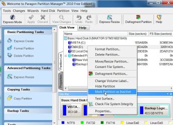

Either go into bios and make Disk2 first in HD boot order, or mark D inactive.
To mark D inactive, use a 3rd party partition manager , e.g. Paragon Partition Manager 2010 Free , or Partition Wizard:
Select Full scale Launcher, Rt click the D partition and select Mark Inactive, click Apply.
Then boot the 7 dvd and run startup repair 3 times.

Hold on Disk 1 is the OS disk that has vista installed
Disk 2 is the DATA disk with the Win7 install
Disk 1 is the first in the boot order, which is exactly the problem. I would like to keep my clean install of windows 7 on the DATA disc intact.

You're right, it should be Disk 2 that is the boot drive. If it is first in Bios HD boot order ( or the first with an Active partition - that will do it)
Then run startup repair 3x to write the boot critical fles to it.
Where is your Disk 0 btw?
