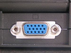

Do you have one of these VGA ports on the computer & a cable that can connect it to the monitor ? Without using your GPU card.

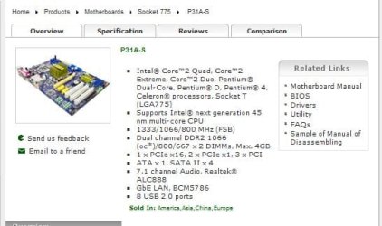

I guess this is your MB ?
Does not look like it has on-board video VGA :(
Do you have any other video cards that will fit in your motherboard ?
on motherboard
6 pata Ide HD's & 2 Sata HD's
All Generic Full Towers
Fast Cable InterNet
Linked via TeamViewer !
No, this is the first proper computer that I have bought, following a few laptops that don't have salvageable parts that would be of assistance. Would it be worth taking my computer to the shop for them to put in a video card that might be compatible and installing Windows there? I am desperate for it to work, I am so sick of XP.
