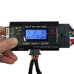

The device my friend brought here was a tester. That device could check the ambers as well...if that makes any sense (I'm not very familiar with the device).
It was this or something like it

Not a problem that is the sort of device although an amateur one that will measure the amps.
