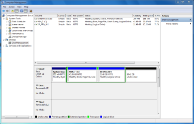

Currently I have:
System Reserved 200mb (System, Active-Primary)
Win7 on first logical (Boot, page,crash)
XP PRO SP2/3 on 2nd logical
DATA on Primary.
Was thinking about deleting all partitions (again) and getting rid of the 200mb system reserved partition as "some" programs in XP might not like being on "D:\"
(XP unlike Win7 "sees" the System reserved partition as "C:")

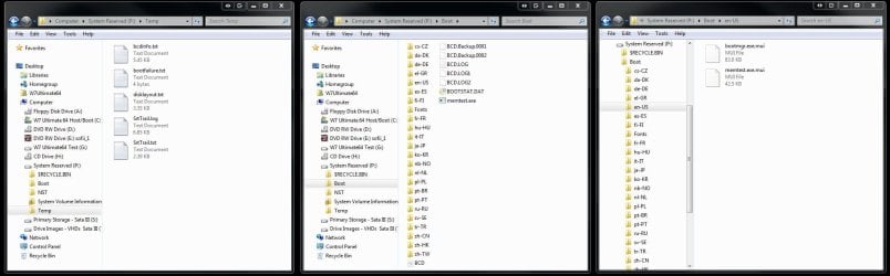

The repair tools are not placed on the 100mb system reserved only the BCD store and boot files in general along with the memtest executable. The image below has been posted previously for an extended lookover of the 100mb itself.
Now as far as installing 7 after XP on the same drive and onto a second primary the 7 boot files are what replace XP's own as far as which then becomes the default OS and which boot loader will be used. During the installation XP will automatically be added into the 7 BCD store as "previous version of Windows" when the boot options screens come up afterwards.
As far as the startup repair or "Last configuration known to work" options those come up if the system sees a crash or hard boot without shutting properly. The startup repair option is not an F8 boot option with or without the 100mb present. The image here shows what is actually on the 100mb itself.
For seeing the startup repair as a general F8 option you would need a reg edit similar to how the recover console was installed as a boot option on the two previous versions. You would need something like that to see it made a regular choice.
As far as Partition Wizard hope you don't have any Sata III drives installed! The PW program is too outdated even with the latest release to even see the pair installed here. Any other partitioning option however indicates the two drives are present. Pity anyone with one of the new Sata III only boards now seen.(Sata III ports only on those)
The 7 drive tools, Disk Part, Paragon, GParted, and others however were not found having any problems with Sata IIIs present. PW is another older however open source partitioning program with it's limitations.

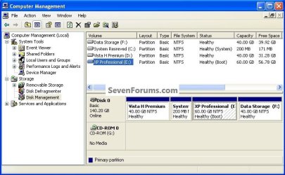

Here's an example of that. ;)

Weren't you saying you hadn't seen an example of XP making the "System Reserved" partition the C: partition and XP being the "next available" partition?
If not, what were you referring to in what I quoted?

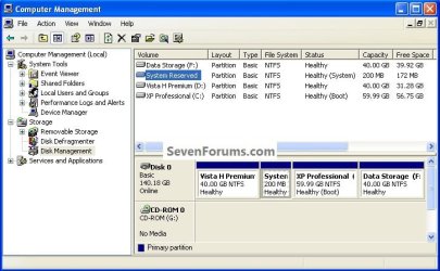

Unlike Windows 7 which "hides" the partition older OS's "see" the partition as "C" which may freak out certain apps, or cause install problems. This is likely to cause operator error and or confusion.
I haven't seen an example of SysReserved when installed correctly without a drive letter confusing apps on older OS's as to where they should be installed.
When installed correctly last and from boot I believe Win7 will always see itself as C and have only experienced that the other multi-booted OS's see themselves as C when booted into them - thus presenting no problem for applications needing install in the booted OS.
I'm not sure why the SysReserved in the screenshot is lettered C. My experience is the default during Win7 install is that no drive letter is issued to SysReserved. It was once required to give it a letter to use EasyBCD, but no longer. So there is no known reason to issue SysReserved a letter, and if an older OS does so it should be ignored.
I wanted to make sure so I just wiped the SysResv, repaired Vista so it would be "System Active", deleted/recreated/formatted the XP partition and installed XP and XP did not install itself as C:; every time I've installed XP it always takes the next available drive letter when installed second after Vista/W_7 and has never created itself as C: that I have seen.
