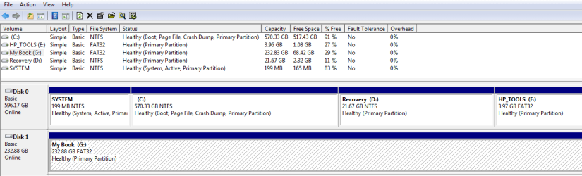

Welcome to the forum if you go in to disk manager does the drive show with a drive letter it may need to have a drive letter assigned
win 8 32 bit
win 8 32 bit
Open Explorer. Can you see the drive? If not, open disk manager, expand the columns so we can read them, with the sniping tool take a snapshot an then post the image as an attachment.

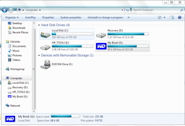

Attached is a snipe of where the back up data are located on the G drive.

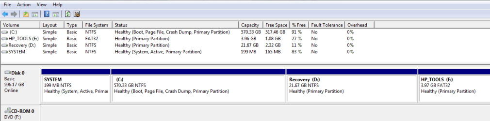

Attached is disk management screen shot.

Sorry, please use this screen shot Capture2. It has the external hard drive

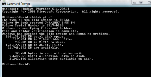

As an external HDD it should have been formatted as NTFS.
Lets do a check disk to see if it's ok and fix any problems.
Open a CMD window and type chkdsk g: /f

Attached is copy of CMD window after typing: chkdsk g: /f
Also went back to backup and restore and hit Refresh button and still does not see local drives.

Your disk is ok.
Try to open Explorer, go to the G: drive, find the backup file and double click on it.

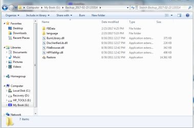

I have open up the back up file. What next?

Right click - open

Sorry to be so dense, but which file? See attachment

The Restore file.
On Explorer settings you should uncheck - Hide extensions from known files.

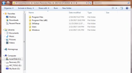

The restored files from my external hard drive are back on my computer. It created a Systems Recovery folder on my desktop. The files are shown on the attachment. I tried to go through the Backup and Recovery in windows again, but I still cannot see the files on my C drive.
I'm sorry but I am not much of a computer person and I don't know how to get those files back to where they came from.

You did a full disk restore.
There are many folders you won't need and it's taking your HDD space.
- Go to the C:\System Recover Files\2017-02-27\C folder (as shown on your above image).
- Select (Program Files + Program Files(86) + SWSetup + Windows) (Be sure Users folder isn't selected) and then hit Shift+Delete.
- Confirm delete of the folders.
- Open C:\System Recover Files\2017-02-27\C:\Users
-There will be a Public and <name> folder. If you used to have more than one user you'll have it shown there.
- Select <name> and there you will find your personal folders (My Documents, My Pictures etc)
- Open C:\System Recover Files\2017-02-27\C:\Users\<name>\My documents
- Select all files and folders (Ctrl+a) and then cut (Ctrl+x)
- Go to C:\Users\<name>\My documents and then paste (Ctrl+v)
- You just moved all your files and folders from C:\System Recover Files\2017-02-27\C:\Users\<name>\My documents (restored backup files) to C:\Users\<name>\My documents
- Do the same (cut and paste) for the other folders - My Pictures, My Music etc

Great. It worked. I now have all the files back on my computer.
Thank you so much for your help and for being patient with me.
